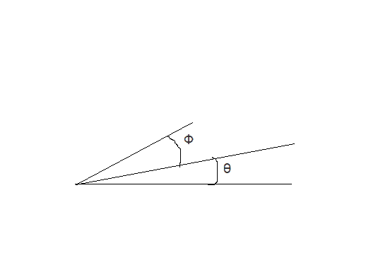

You fire a ball with an initial speed at an angle Φ above the surface of an incline, which is itself inclined at an angle θ above the horizontal (see the above image). (a) Find the distance measured along the incline, from the launch point to the point when the ball strikes the incline. (b) What angle Φ gives the maximum range, measured along the incline? Ignore air resistance.
I tried to do this one using
x = y / tan(phi + thetha)
y = v_0sin(phi + theta)t - (gt^2) / 2
x = v_0cos(phi+theta)t => t = x / (v_0cos(phi+theta))
But it seems to get too complex and am not sure whether it is correct.. my solution got a bit messy + incorrect
Thanks in advance!

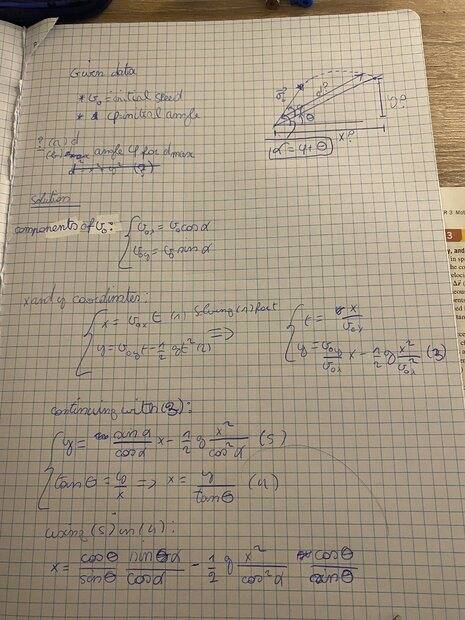

One question
I rewrote it a bit clearer, so from this step at the end of the page it’s all about what is said in the thread of the predecessor? The above is done how it ‘should’ be then

Toughh i guess I am having problems with the final algebra every x (trig subs actually)
I gave you a link to a thread with a slightly different problem statement (target given, angle to be found).
Your problem statement gives angles and asks for a distance to target along the slope.
My guess is you're off track because you end up with an equation in ##x## that does no longer depend on ##v_0##. That is very strange...

or just too complicated because i do have v_0^2 but I forgot to invlude it in the denominator of the quadratic term for y
OKAY! I found this.. The exact same way as i have done!
https://www.toppr.com/ask/question/a-projectile-is-fired-up-an-incline-incline-angle-phi-with-an-initial-speed-vi/
BUT... the step he immediately calculates d is where I am lost...
it’s amazing how many ways yoj can solve such a problem tough lol
it says (in your notation) $$d\sin\theta = d\cos\theta\tan\alpha - {1\over 2} g \ {d^2\cos^2 \theta\over v_0^2 \cos^2\alpha }$$so of the form ##d(d-z)=0## with non-trivial solution ##d=z##.
BvU said:
Oh, really ?
yes, the next step was the problem haha, that was the easy step, but then the reformation was not really clear
$$0 = d(\cos\theta\tan\alpha - \sin\theta) - {1\over 2} g \ {d^2\cos^2 \theta\over v_0^2 \cos^2\alpha }$$
So d= 0 or $$(\cos\theta\tan\alpha - \sin\theta) - d \; {g\cos^2 \theta\over 2 v_0^2 \cos^2\alpha }=0$$meaning ##d = ...##
