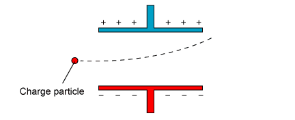

If a charged particle moves through a potential difference, it gains kinetic energy but does it also lose potential energy?
When I accelerate a particle and then I "free it", what happen to its potential energy if the total energy should be conserved?

Yes I know, maybe my question is very wrong, but if I have this apparatus:
Before: particle have a kinetic energy with v1 and so total energy = kinetic energy.
Enter: particle is due to the force, that is conservative, so E is conserved and gain kinetic energy ( loss potential energy).
flow Out: It has only kinetic energy, but is different from when is inside, because there are no more "potential" energy they have relatively to the position in the field.
I think I'm wrong because potential energy have a meaning only when the particle is in a field so there is potential difference ( this is what interest) and energy is conserved because inside the field do a work and convert that work in kinetic energy, is correct?
thanks
If we take that diagram at face value: there are six positive charges (held in place by an external force) and likewise six negative charges. Then, we have a charged particle moving through the electric field created by those charges. That electric field does not exist only within the plates. It may be an approximation that the force only acts on the particle while it is between the plates, but if you look at the set-up fully, then there must be a potential outside the plates. In particular, a negatively charged particle must have more potential energy before it enters the plates than afterwards, if it moves as shown on your diagram.

You did not draw the important part. I mean the line ends where the particle is not yet free.
