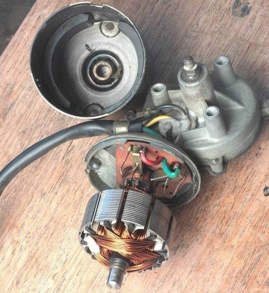

i just noticed your post about the windshield wiper motor.
""The motor has red, black, yellow, brown and green wires. With R/B to +/-, touching yellow and brown makes the motor run for about 2 seconds, stop, then go for another 2 seconds in the same direction.""
It sounds like your motor has internal electronics. Can you remove a cover and get at wires going to brushes and field? Was it junkyard or can you post a datasheet ?
Fords were the same from about 1960 to at least mid-80's. I never messed with any others.
Its just from a junkyard. I will try to disassemble it now.
ok photo attatched. yellow and brown appear to go into the gear housing.
  • Disassembled small universal motor on a wooden surface: wound copper armature with laminated core, brush holder with wires in red, green and yellow, a black cable, and a separate gear housing with its cover removed.

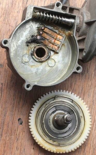

ok I took apart the gear section, a photo is attatched. Its pretty simple, 3 contacts touching tracks on the rotating gear, changing how the motor operates as it spins. I am going to muck around with this for a bit.
  • Photo of a disassembled gearbox: an open metal housing with a coil spring and three spring-loaded brass contacts over a bearing, with a white plastic gear and shaft lying beside it on a wooden surface.
oh my gosh - a permanent magnet field!
i expect a third brush opposite the red wire
power from that brush to one opposite should run the motor.
bypasssing switches entirely.
With that permanent magnet field your PWM will control speed.
Probably prudent to place a rectifier across the motor terminals. this is called a "flywheel" diode purpose is to absorb motor's inductive kick.

It doesn't look like it.
There is indeed a third brush opposite red.
Hooking up the wires that come straight out of the motor, red and green, works a treat.

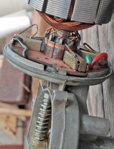

About that rectifier, the PWM kit came with a 100nF MKT capacitor to be connected across the motor terminals. I forgot this bit and ran it for less than a minute, hope i didnt do too much damage. Do I place the rectifier inside the case, bridging the red brush with its opposite? What if it gets bumped and gets caught in the mechanism?
as you can see in attatched, red and green are next to each other. i only applied power through these contacts and it still worked well. But ideally I want to only use red and black, correct?
there are no semiconductors or ICs anywhere.

I think motor will run better with power applied to physically opposite brushes.
Of course polarity determines direction of rotation.
I'd mount flywheel rectifier outside not inside..
It will be reverse biased in normal operation so cathode goes to positive..
get a six amp or so, ... unless there's already one built into your PWM which is likely if it's made for motor control.
the capacitor just cuts down on RF from arcing at the brushes so may or may not affect your PWM if absent.
Probably running it without cap hasn't hurt a thing.
How's the torque feel to you? Your machine is bigger that i thought, still those wiper motors are stout.
