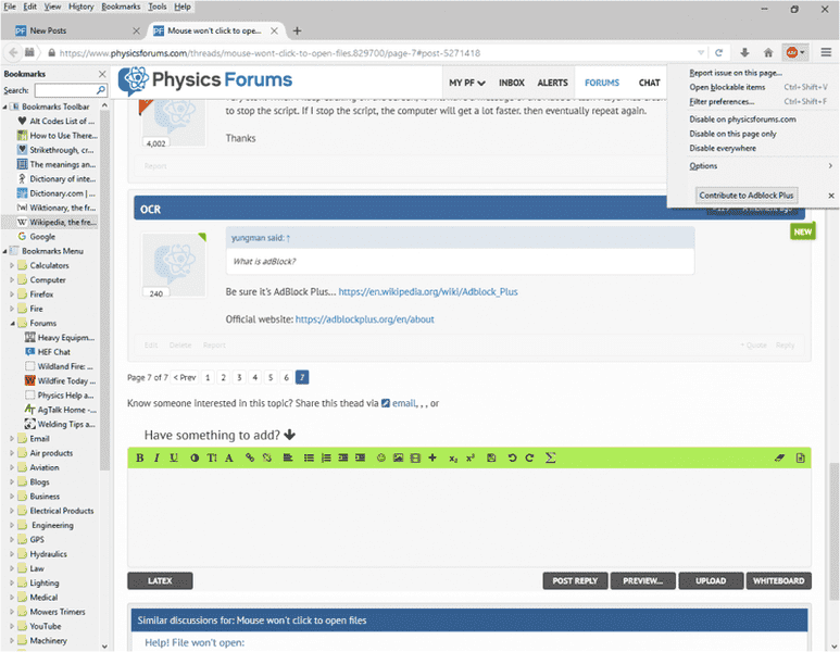

Here is a snip of what I just posted... lol
