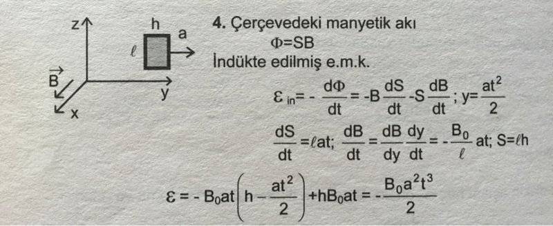

Hello,
Short description: In my country's physics olympics, if a loop of wire is moved in a changing magnetic field, the time derivative of the area (while calculating emf with lenz law) is the velocity of the loop (as if we're taking the time derivative of the AREA SWEPT).
This has became an axiom for me right now. I do the questions based on this and they are correct, so no problem practically. I am just wondering why.
Here's an example question and its solution if I wasn't clear enough.
The loop is moving with acceleration a in the magnetic field defined. Find emf as a function of time
What I'm talking about happens in the beginning of the third line of equations.
Thank you

Let me disagree. As the loop moves to the right the magnetic flux changes. However, the OP shows a contradiction: it states the loop area S=l*h (a constant, O.K.), but in another place makes S a function of time (wrong).
Hmm, good point. Confusing.

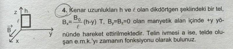

@avcireis: Can you translate the problem statement as accurate as possible?
Sure,
Question: A rectangular loop of wire with side lengths h and l is moved in the y+ direction in a magnetic field Bx=B/l (h-y), By=0, Bz=0. If the loops acceleration is a, find the emf generated as a function of time.
Solution's first line: Flux through the loop
Solution's other line: Generated emf

but that's far from the solution. I also don't understand, why they simply write ##\Phi=BS## although you need an integral, because the ##B## field depends on ##y##. Something seems to be wrong either with the solution or my understanding of the question.
I agree with your answer vanhees (Edit: oops), and the solution in the book doesn't make sense.
The formula for dS/dt would suggest that the loop expands, e. g. the left edge stays constant. But that is in contradiction to S=lh used later.
The multiplication with B would only work if B was constant in space, or if they take the average B. We know it is not constant in space and I don't see any averaging process. dB/dt seems to get evaluated at the right edge of the loop.

which is a bit closer to the given result but not quite the same. The reason is that in the solution they didn't correctly evaluate the flux, because they tacitly assumed that the field is just to be substituted with ##B=B_0 (h-at^2/2)/l##, which however is obviously wrong.
I'd go for vanhees's first answer.
Let us assume that at time t = 0 the left hand side of the loop is at y = y0 and moving with velocity (0, u, 0). We shouldn't, imo, have to assume these initial conditions; they should be given in the question.
The loop is translating in the y-direction without change of shape. Given the diagram it would surely be perverse to assume anything else.

That makes sense, vanhee's first answer. I'm going to ask my tutor about this. It seemed like an error to me as well. It might be, since these questions I'm talking about were back in 1990's and the national science olympiads were not funded that much back then, so they weren't as professional.

Another sniffy remark about the question… What's that 'T' doing at the end of the expression for Bx? Presumably it stands for tesla. Does that mean that B0 is to be regarded as a pure number without units? Weird.
@Philip Wood, it's true. T just stands for the unit Tesla.
Did you get the point I was making about its being wrong to put the unit there at all?
Incidentally - here's a tiny nitpick - In the SI, when a unit is named after a person (e.g. Coulomb, Hertz, Tesla) the unit, written in full is all in lower case (coulomb, hertz, tesla). The abbreviated unit is upper case, or if two letters, the first is upper case (C, Hz, T). Just trying to be helpful!
My tutor also approved vanhee's solution and said that the book I'm using is notoriously known for its mistakes. Thank you to everyone!
