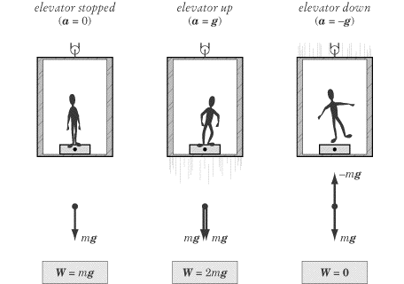

In this diagram I don't understand picture 2. Why is it 2 mg? Isn't gravity acting downwards?
What they are calling 'W' in those diagrams is the 'apparent' weight, which we have called the normal force. Yes, gravity acts downward. In picture 2 the elevator is accelerating upwards with an acceleration equal to 9.8 m/s^2 upwards. So the normal force is twice the usual value (when in a non-accelerating elevator.)
If elevator is accelerating up why does normal reaction force increase? Doesn't these diagrams have 3 forces. This is my misunderstanding. In the 2nd diagram I'm thinking this.
Upward force on the person= ma + Nr- W(from gravity)
Tell me why this is wrong? Thanks!
Why does it show weight force acting down if it is normal reaction force? which should act up?
Those diagrams are viewing things from the non-inertial, accelerating frame of the elevator. So they show inertial forces as well as 'real' forces. Unless your class is studying non-inertial frames of reference, I strongly suggest that you stick to an inertial frame of reference.
From a non-inertial frame of reference (as shown in those diagrams) for diagram 2, the forces are:
(1) gravity (mg) acting down
(2) inertial force (equal to -ma = mg) acting down
(3) normal force acting up
These add up to zero, so: -mg -mg + N = 0, thus N = 2mg.
Viewed from the usual inertial frame of reference, the forces are:
(2) normal force acting up
These forces add up to ma = mg upward, so: -mg + N = mg, thus N = 2mg.
