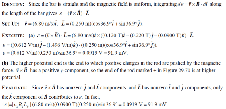

this is how it should be solved, but i don't get why is so :oldconfused:
Is there a step you're not getting? The first step (labeled "Identify" in the given solution) is key and it's just what I had stated earlier. That's what you were doing wrong.

what i am not getting is from this point on, the second passage doesn't match the first
Sorry, but I'm not seeing which passages don't match.

it starts with this
then it splits ##\vec L## which is the length of the rod in vector components as follows

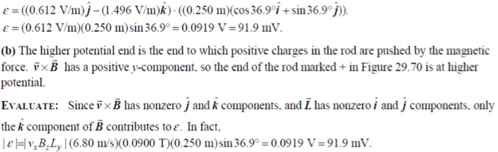

you said to not take the scalar product with ##\vec L##, so why is the length in vector components?how do you get this result below? this is what i am not getting. Where is (-1.496 ##\frac V m ##) ## \hat k ## gone?
what is that sin(36.9) doing there?
No, I said not to take the cross product with ##\vec L##. (Which is what you were doing in your first post.) But do take the scalar product!
Since ##\vec L## has no ## \hat k ## component, that term vanishes after taking the scalar product.
That's from taking the ## \hat j ## component of ##\vec L##. Note that only the ## \hat j ## components survive the scalar product.
