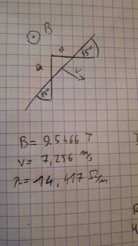

The rod is moving on a second rod with speed of v in the magnetic field perpendicular to rod. I know its resistance per meter. I am expected to omit megnetic field created by the current and resistance at the point where rods touch each other and calculate current. I presented the situation with drawing ( the same as in task). My calculations occured to be wrong. Why?
I=Emf/R
Homework Statement: The rod is moving on a second rod with speed of v in the magnetic field perpendicular to rod. I know its resistance per meter. I am expected to omit megnetic field created by the current and resistance at the point where rods touch each other and calculate current. I presented the situation with drawing ( the same as in task). My calculations occurred to be wrong. Why?
Homework Equations: I=Emf/R
Emf=-dA/dt*B
  • Handwritten sketch of two rods crossing at 15 degrees on grid paper, with B marked as a dot-in-circle out of the page, sides labelled a, and velocity v drawn perpendicular to one rod; below it are values B = 9.5466 T, v = 7.256 m/s, and λ = 14.417 Ω/m.

Check the area of the triangle as a function of time. Also, try using LaTeX for writing your equations instead of posting photos some of which are sideways.
