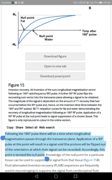

In STIR, 90 degree read out pulse is given at Time to inversion TI( short TI) where the Mz of fat tissue is zero(null point). After giving 90 defree pulse ,Mz is transferred to Mxy plane and since Mz is zero, can Mxy be also zero?
<< Mentor Note -- related question merged into the OP's existing thread >>
I don't understand the highlighted words and the figure.When 90degree RF pulse is given, is Mz which is zero moved back to -Mz or still staying at transverse magnetization plane?
Yes, that is the basis of most magnetization preparation techniques.
