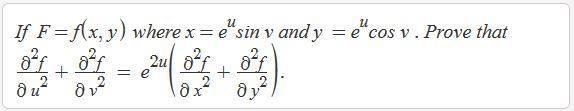

Typeset problem: If F = f(x, y) where x = e^u sin v and y = e^u cos v, prove that the second partials of f with respect to u and v sum to e^(2u) times the sum of the second partials with respect to x and y.

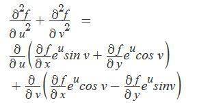

By chain rule,
Equation: ∂²f/∂u² + ∂²f/∂v² = ∂/∂u(∂f/∂x ∂x/∂u + ∂f/∂y ∂y/∂u) + ∂/∂v(∂f/∂x ∂x/∂v + ∂f/∂y ∂y/∂v)
which simpifies to,
Handwritten-style equation: second partials of f with respect to u and v summed equals partial u of (partial f/partial x e^u sin v + partial f/partial y e^u cos v), plus partial v of (partial f/partial x e^u cos v - partial f/partial y e^u sin v).
After this I am struck.
Take into account [itex]\frac{\partial}{\partial u}=\frac{\partial x}{\partial u}\frac{\partial}{\partial x} + \frac{\partial y}{\partial u}\frac{\partial}{\partial y}[/itex] and similarly for v.
