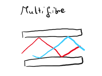

I have a problem understanding how light works in multimode optical fiber.
What do I mean in single-mode optical fiber there is single light which contains information. In multimode there can be multiple lights with multiple information.
Like here 1st picture contains multiple information.
I know also from physics that when the light beam crosses with each other then they sum up with each other and can get stronger or weaker like here :
Or here :
Doesn't the light in multimode also cross with each other like here ? And if so doesn't it change the information it contains ?

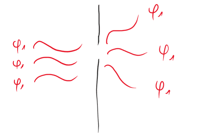

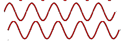

I know that lasers have the same phase for each direction so when 2 same phases cross with each other doesn't it always increas the amplitude because they are in the same phase like in picture nr.2.
Like here :
Laser and it spreads into different directions but because it is a laser it has the same phase not like in light bulb in which light has different phases.
Adding another laser will make now 2 light that have the same phase crossing each other. Will it increase the amplitude or decrease like in picture nr.2 ? They have the same phase but different direction so ?
Thank you and sorry for asking many questions.
EDIT :
Sorry it's in polish. But here it is shown that two lasers have the same phase, they are not shifted.

As I can see they same the same phase.
Look at the second blue box it looks exactly like they are in phase so it should be increased but as some point it increases and at some it doesn't like here :

That's a really abysmal attempt to describe it; no wonder the OP was confused. In most fibres, other than the very thinnest, there are many different paths through the fibre, depending on the angle of entry from any single laser source (same original 'stream'). This would be multimode propagation. Getting most of the light power into the fibre is hard and the optics of launching will produce different delays over the different paths (imagine the 'fan' of rays entering the face of the fibre). The different delays will produce a number of 'pulses' at the other end, all at slightly different times, which blurs the transitions. (Inter-symbol interference) The spread of delays increases with fibre length so long fibres have a lower possible symbol rate. Also, bends in the fibre add to the effect.
A monomode fibre is thin enough to provide just one path and that is from just perpendicular incidence. The curve of a fibre has less and less effect as it is thinner and the single ray ('mode') propagates over a long distance. Of course, it's even harder to get a lot of power into a single mode and the optics is more demanding.

If you were able to insert a probe into the multimode fibre, you would see interference effects happening. The two waves do not interact, the fields just add or subtract, giving local positions where the intensity is higher or lower. The addition of the two waves can never give you more energy out than energy in, it is just that in some positions the power density is increased.

I understand I guess that multimodule gives more "paths" for single light in which this single light is bouncing from one side to another.
I don't understand the moment with the power light.
Also the delays does it mean that from one source of light we can get more ? And each one of them can have different delays ?

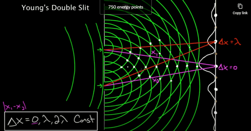

I've watched it, some of the things he had mentioned was very interesting like this :

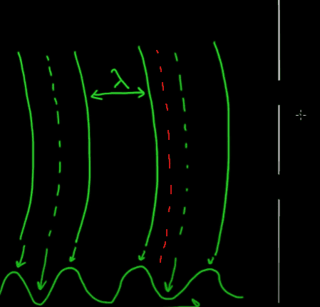

I've added one element (in red lines) this isn't the peak as I know right ?
So what if a peak lines up over a not peak then something can happen ?
Also as I can understand from this picture is that it is the representation of the laser ray ?
So if I had laser rays in the fibre optic it would look like that ?
And in scope it would look like that ? :
Now I wonder because they have different wavelength then they do not interfere, but if they had the same wavelength then they interfere in the middle and then nothing happens after that ?
Because here :
This effect of lining up of the wavelength will result in the end like in the picture.
Xenon02 said:
Green lines represent peaks of value +1 and half way between them are values of -1 (troughs)
The white dots are places where the peaks (+1 and +1) coincide and the result is twice the amplitude(+2) of one. Where two troughs coincide, the value is -2. The fringes (white bumps) represent high energy arriving over each cycle and are at the end of the lines of white dots and (not drawn) troughs.
At your brown 'dot', there is a peak (+1) and a trough (-1), adding together to produce an amplitude of zero. Zero energy flows in this direction.
Other combinations will produce +1+0 = +1 in other directions.

What I meant is that the wave is a sinusoidal so the peaks are at certain points but those waves have also spots where there is no peak like here :
I've used the red color to show it. It is not the peak it is something between the peaks.
And I was wondering what happens if not a peak lines up with peak.
Why at the end some peaks are stronger than the other peaks ? The center peak is stronger than the side peaks. Does the energy overlap ? Because before it was said that those increases doesn't stack, like it increases but when it exits this spot then it comes to normal here I see that they stack up.
A and what do you think of my interpretation of light rays in fibre optic multimode?
@sophiecentaur I don't know if I conveyed exactly what is my problem but I slowly am getting how things works.
I just don't get what happens if we have not the peak of waves but something in between ? Like peak wave lines up with not peak. Or why peak of the wave lines up with the valley peak of the other wave even though they are in phase. Also why the light gets weaker do they stack up ? I read that interference doesn't stack up it just interfere and when they exit this point then they are normal without any increases or decreases.

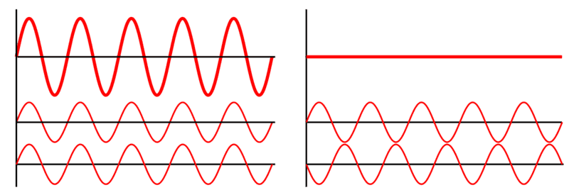

For every peak (call it +1) there is an opposite trough (-1) these values are either side of an average value of zero. As the wave is sinusoidal, there is a continuum of values between peaks and troughs. "not peak" is not a meaningful term because it can refer to anywhere that's not an actual positive peak.

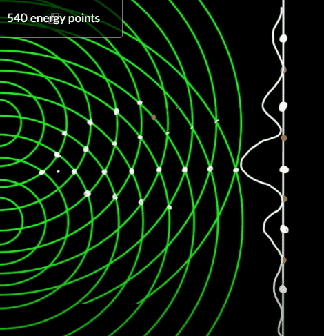

At the 'projection screen' waves are arriving everywhere. At the peaks of the pattern, the variation is between +2 and -2. elsewhere, the variation can be between +0.4 and -0.4 or +0.00012 and -0,00012 or any other values. At perfect cancellation, you get no variation about zero.
Personally, I find demonstrations of surface water waves very difficult to make sense of because the propagating waves get messed up by other standing waves that always seem to show up and also, flickering lighting upsets things too. I'd say that interfering light waves, accompanied by well drawn diagrams are the best way in. Yes - it's abstract stuff but so is a lot of Physics.
Read the descriptions more carefully and try not to let your own model of what's going on interfere with grasping the accepted model.

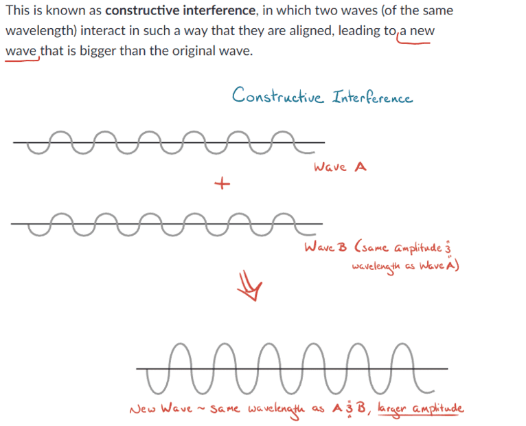

So let me use paint as a my understanding point :
in this picture there is an interference.
On the screen I can have +2 colored by green dots or I can have less but still increased colored by blue let's say it is +1 or 0.
So at the end of this interference from this video you have send me :
This big increase is exactly the green dots I have shown in the picture before ?
And also increase but smaller on the side are like my blue dots like in the picture before ?

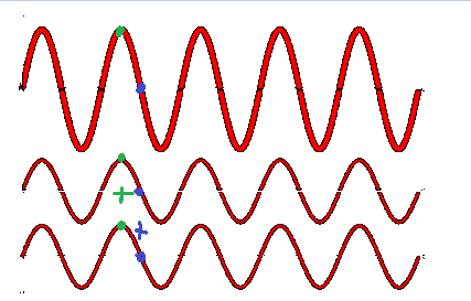

Also what did I mean by not peak lining up with peak amplitude, something like this :
Not in phase because here :
But it works ?
Also the author of the video said that the waves are in phase but here it doesn't look like that.

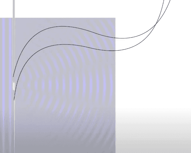

They are clearly in anti phase there (in the direction of the gold points) - resulting in a zero sum. I can't be bothered to find this in the video but did he really say that? Of course they are always in a constant phase relationship at any point on the screen so the result will be a sine wave - just with different magnitude.
Have you taken on board the importance of the + and- signs in the combining of the waves?

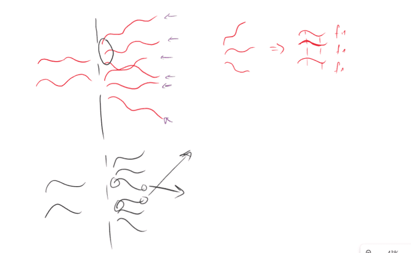

I mean here is also shifted in phase waves :
Because those waves can meet each other like that if they can meet if it's shifted 180 degrees.
I just don't understand the logic of why it is shifted. And why on the screen only the middle one is the strongest and further they are weaker.
Because tech and you mentioned that they interfere but when they exit they are again normal :

the phases they are in phase but they can cross each other when they are shifted in 180 degrees.

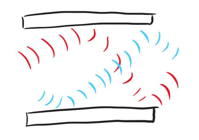

but what if they cross like that :
They can meet like that right ? Even if the rays are in phase in every direction like you mentioned.
Sorry I get confused ...

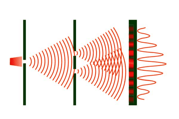

It's the difference in path length that causes different phase difference as you look along the screen. It's a very sensitive test of length and it is used for Interferometry to measure tiny movements.
I don't really understand it is it possible to give a sketch of how it looks like ? Difference in the path doesn't tell me a lot, but okey let's say there is this difference in the path.
Usually when there is interference then +1 peak lines up with +1 peak or +1 peak lines up with -1 peak.
But what if it's in between like here :
Also I asked there why on the screen there is only one very bright point and the other bright points are weaker than the middle one.
Like here.
Beause it looks like the interference are stacking up ? Like +1 lines up with +1 then it's +2 then +2 lines up with +1 and it's +3 ?
I thought of it like that but it was mentioned that the wave when it exits the interference it comes back to normal like here quotes :
Let's get this out of the way first: the peaks are not all the same height because the slits do not produce an omnidirectional pattern. It's a practical problem, due to diffraction. Light off to one side is less intense because the slits are not infinitely thin. You must wait to understand about this and it's not relevant to the basic process.

Where does the path difference come from?? Those concentric circles show equal steps in time delay. Look at the distance from one slit and the other; equal from each slot at points that are along the central line, it's always a different distance from each slot. If the difference is a whole number of wavelengths then you get constructive interference.
Distance from the slot corresponds to total phase delay.
distance from one slit and the other you mean a single source or the slits from the connecting both sources ?
