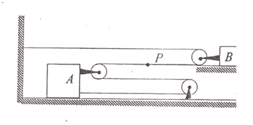

The block B moves to the right with a constant velocity of 30 cm/s. Given this, which of the following is correct:
1. Speed of block A is 15 cm/s
2. Speed of point P is 60 cm/s
3. Speed of point P is 30 cm/s
4. Speed of block A is 40 cm/s
Fnet = ma ?
I don't know where to start. May be I will have to take each block separately, but I do not know the mass of either A or B nor the velocity of B.
http://www.pictureshack.us/images/346Q.png

This problem has nothing to do with Force, Work, Acceleration, mass or friction. It is all about speed -thus the distance traveled each unit of time.
In a short period of time, B will move 3 cm to the right [it is traveling at 30 cm/sec]
What happens to the length of the top string while that happens?
Where does that extra string come from or go to?
How far will P and A move in that same time then?
Given the options, you can hope that P moves either 6 or 3 cm, Or A moves 1.5 cm or 4 cm.
More importantly, only one of those had better happen or there is more than one correct answer.
I think the point P should also move with the same velocity as block B as the string at the top increases in length. I thought the answer would be choice (3), i.e. 30 cm/s, but apparently this is wrong and the answer is given as (2), i.e. 60 cm/s. This has me confused.
If you put a reference point on the top string - call it Q - and consider the 3 cm move I suggested then ...
Q will be 3 cm further from the top pulley [Q is tied to the wall and the pulley is tied to B, which has moved 3 cm to the right].
That means the top string is 3 cm longer that it was.
That can only happen if 3 cm of string passes around the top pulley.
That will mean P moves 3 cm closer to the pulley; a pulley that has moved 3 cm.
Thus point P must have moved a total of 6 cm; meaning P is traveling at twice the speed of B - so 60cm/sec.
