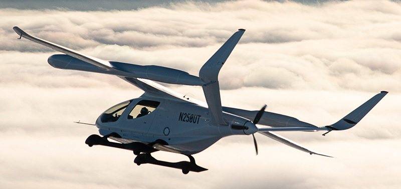

Or you can look at batteries and electric power. These people are getting over 250 mile range, vertical takeoff, and vertical landing with battery power: https://www.beta.team/aircraft/. It's larger than you are interested in, but gives an idea of what can be done with batteries and electric motors. They claim a useful load of 1400 lbs or six people. And it has a wing, so could glide to a landing on a total power loss.
If you search the N number (N250UT), it has flown several 1.5 to 2.0 hour flights recently.
WITW? They do indeed claim VTO on their website, but how? I don't see any pics of the configuration for VTO on their website, and don't see any way to either tilt that aircraft onto its tail (plus the tail rotor is way too small for a balanced VTO), or to tilt the rotor.
How does it take off vertically?
It looks like it is actually a quad-copter. It doesn't sit on its tail. In the photos, you can see 4 rotors aligned with the two front-to-back braces on the sides. The rotor on the tail is for forward motion after the vertical takeoff.

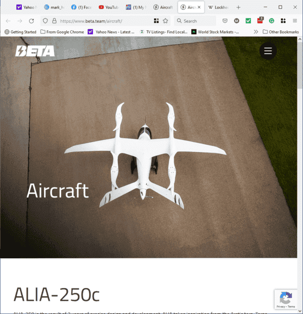

You must have X-ray vision or something --- I can't see anything like that

Vanadium 50 said:
Ask and ye shall receive:
No, not the V22 or Harrier: I have seen at least one of those in VTOL mode with my own eyes. However I was referring to the scam design presented in #7: I don't see any evidence that the fraudsters engineers have produced a working model that can VTOL, and there is no evidence of rotors on the images of N250UT.
The first photo on their website is clearer. You can see the 4 rotors, but they blend in well.
Yes, funny how CGI always looks clearer.
Weird. I see that now in the line drawing and overhead pic with the rotors aligned front-to-back for aero flight forward, but the pictures on their website show only bumps in those two braces, not rotors in the test flights.
It's not clear how far along they are in development. It looks like they have a flying plane without the rotors and the final goal is to get vertical takeoff with rotors. But It looks to me as though they still have work to do.
They are showing you two pictures, one of an aircraft with little bumps on its wings that can fly, and one of a model (or CGI mockup) of something with 4 "rotors" for which there is no evidence, or indeed direct claim, of its ability to fly. The association of the picture with the thing that flies is deliberately deceptive, and this deception clearly fools at least some of the people at least some of the time.
On closer examination, that's exactly where they are right now. They are currently flying it in airplane mode. Flightaware shows a 2 hour 5 minute flight on June 26, 2022. That's impressive for a battery powered airplane.
The concept is vertical takeoff in a quadcopter configuration, then use a fifth motor to move it horizontally. The horizontal velocity generates enough lift from the wing to unload the lift rotors, after which the lift rotors are stopped and stowed. The idea of rotors for vertical takeoff and a separate propeller and wing for horizontal flight appears to have originated with Jay Carter. He built a gyrocopter with a wing to demonstrate the concept, and was able to show proof of concept: http://carteraero.com/home2/ and https://en.wikipedia.org/wiki/CarterCopter.
