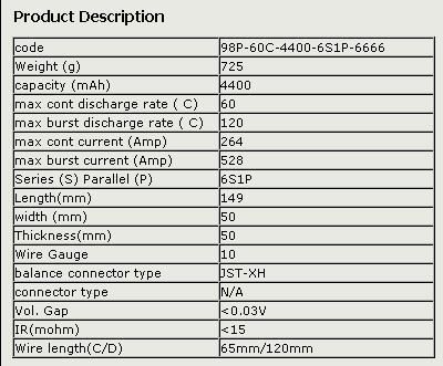

They can supply the current, Gens Aces Lipo 4400mAh 60C constant discharge 120C peak. It's for a coilgun so I'm only trying to light up for a few ms. This time it went wrong but I disconnected pretty quickly between 1 to 2 seconds. I don't remember the IGBT number but it was rated high enough. I'll be going with something even beefier next an SOT-227 packaging MOSFET rated for 480A next and going to use a heatsink for it too this time.
The copper magnet wire is rated for 155C but I was getting worried it got pretty hot.

BTW that's quite a battery.
http://www.gensaceusa.com/98p-60c-4400-6s1p-6666.html

Yeah that battery is a beast huh hehe got it for half off too. I actually have a second one, was planning to run them in series haha. I'll probably limit the current to the first coil though as it's going to be on for the longest. This is meant for a multi stage coil gun btw.
Make sure that you keep count of the Ahrs you are taking from it for these experiments or you can damage it and lose its capacity. Batteries shouldn't be taken below HALF their nominal capacity. (take no more than 10Ahr from a 20Ahr battery) Manufacturers are naughty in the way the specify their batteries. Your "Beast" could soon be a bit feeble if you aren't nice to it. :frown:
