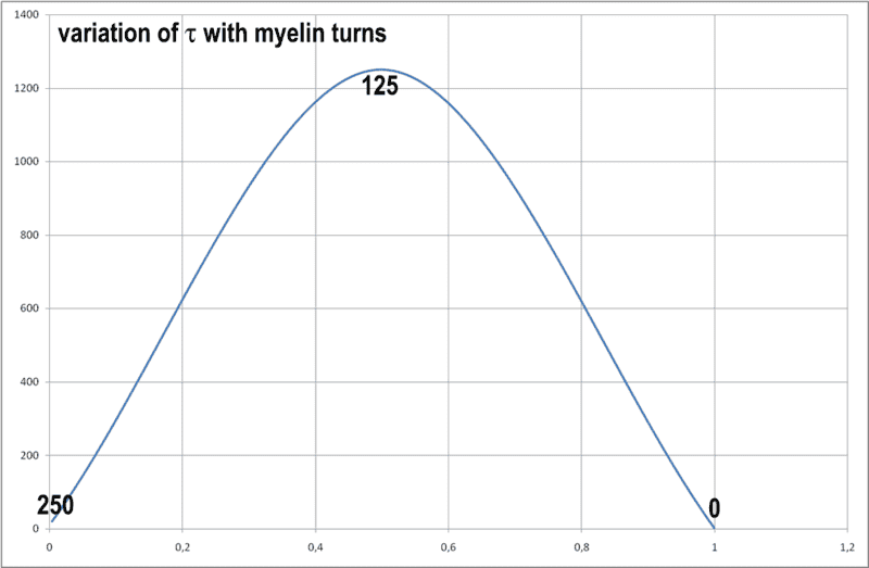

atyy said:
Yes - but only "same order of magnitude" - Koch: Even though the length of the interaxial node is typically 1000 times larger than the node, its total capacitance has the same order of magnitude.
Someone is wrong: Is it Mathematics or Pr C Koch?:redface:
Edit: 250 turns does not change anything since 250 < 1000
Order of magnitude means correct to within a factor of <10 (I usually think ~3-4)
So I think we need better numbers, and from the same species - not some squid, some frog, and some rabbit ...
But Rm varies inversely to Cm and they are linked...
You may test a simple linear function:
Rm=f(C)=-a(C)+b
with the function:
The minimal value found with 250 turns is a Time Constant that is multiplied by a factor 20.
the worst is... 1250
