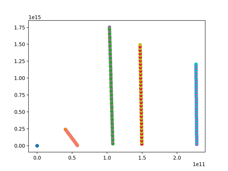

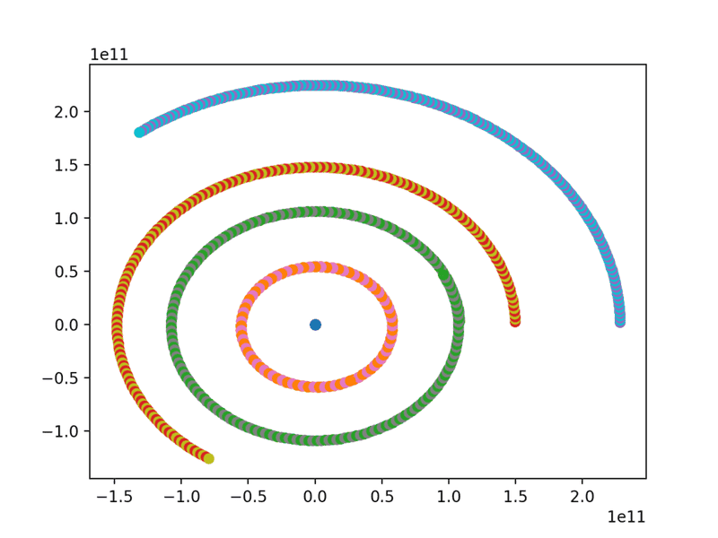

The problem is your typical N-body simulation, implemented using Python and Numpy. The implementation specifically calls for using the Euler-Cromer method. For this particular case I used the Sun and the first 4 planets of the solar system.
Essentially the problem is I'm getting straight orbits, tending towards infinity. Attached is an image of the output.
[/B]
The following are the equations used to evaluate the system :
$$\mathbf{a_i} = \sum^N_{j \neq i} \cfrac{Gm_j}{|\mathbf{R}_{ij}|^3}\mathbf{R}_{ij}$$
$$\mathbf{v_i}(t + \Delta t) = \mathbf{v_i}(t) + \mathbf{a_i}\Delta t$$
$$\mathbf{x_i}(t + \Delta t) = \mathbf{x_i}(t) + \mathbf{v_i}\Delta t$$
[/B]
Below is my code (commented as best as I can) - I tried various slight alterations, such as calculating the position first, the the velocity, rather than the other way round - but to no avail!
My suspicion is something related to the acceleration - I simply cannot figure out what. I noticed (after printing 10,000 values!) that as the x-coordinate of a body approaches zero, the y-coordinate simply increases more and more, and never goes below it's previous value. In order words I noticed the following issue with regards to the y-positions (which I cannot understand why or if its actually an issue) :
$$y_n < y_{n+1} \ \text{(always)}$$
Appreciate any help - Cheers!

Assuming you use SI base units, your initial velocities are a large fraction of the speed of light (or even above that for Venus). At that speed you won't see a relevant gravitational influence of the Sun.
Much better now - I feel silly for copying those off my assignment sheet without noticing the mistakes! Cheers!
