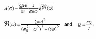

a) Light of wavelength 510nm is emitted by an electron in an atom behaving as a lightly damped simple harmonic oscillator with a Q value of 3 x 107. Find the natural frequency of the system.
b) Find the width of the resonance.
Knowing the Q value means that I need to know γ in order to get ω0. Gamma is b/m and m can be found in tables, but what is b for an oscillating electron?
For part b, I know that the width of the resonance is 2γω0, but again, what is gamma for an oscillating electron?
