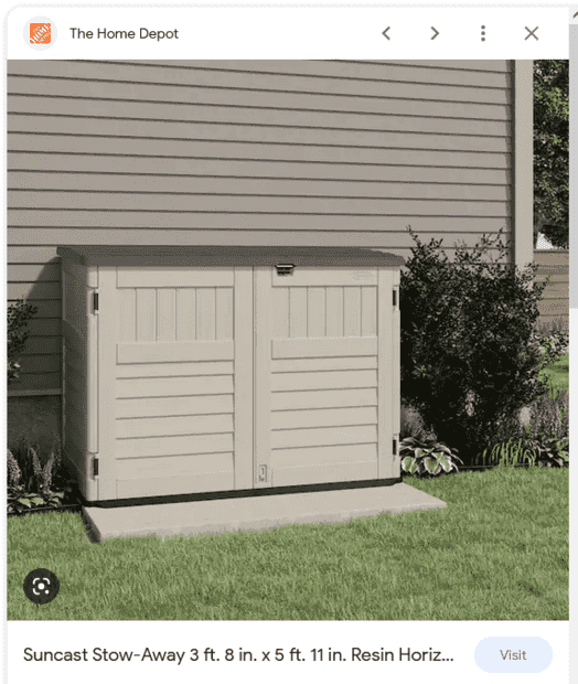

Can you instead just place a small storage shed/cabinet outside in the shade next to your house? That will keep the odors out of your garage, and any odors will quickly dissipate outside once released from the shed.
Likes Rive, Bystander and Lnewqban
