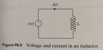

The voltage across the inductor is given by v(t)=L(di(t)/dt).
Determine:
(1.) Tthe voltage v(t)
(2.) The power p(t)=v(t)*i(t).
(3.) The maximum power transferred ( t = ? (in seconds) when power is at maximum).
if the inductance is L=2 and the current i(t) is given by:
