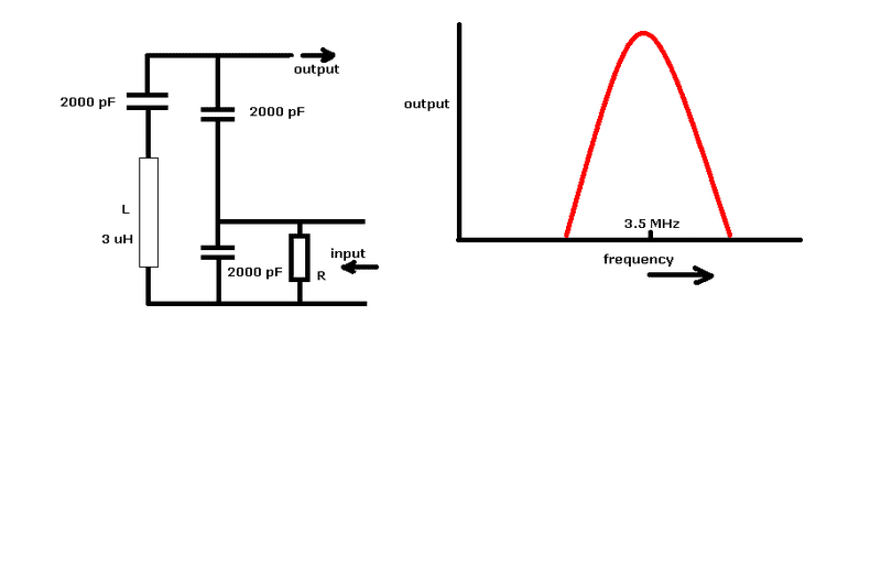

To understand this oscillator, you need to look at the tuned circuit on its own.
Consider a signal source feeding the tuned circuit as in the following diagram:
This produces a peak in output at about 3.5 MHz as shown. I verified this by building it.
Now if this output was connected to the gate of a suitably biased source follower, the FETwould feed almost the same input to its output at some power gain. This would then act as the input to this circuit.
As there is a voltage gain here in the tuned circuit, and some rapid phase shifts, the input to the FET would keep rising and produce oscillation when the gate voltage is in phase with the source voltage.

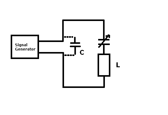

The coil resonates with whatever capacitance is across it. In this case, that is the 3 capacitors in series.
This is not affected by how you drive it or by where you take output from it, as long as you don't add extra reactance to the circuit.
It is tempting to classify these circuits as series resonant or parallel resonant, but the difference is only in where you look at it.
In the above circuit, you would say the tuned circuit is series resonant. But it is very dependent on the output impedance of the signal generator. If this is 600 ohms, you may not even see a resonance dip.
Putting a capacitor across the signal generator allows the tuned circuit to resonate properly. So the circuit only resonates properly if it has a complete circuit of capacitors across it.

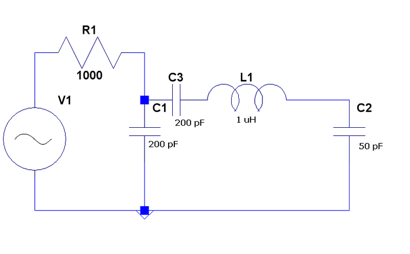

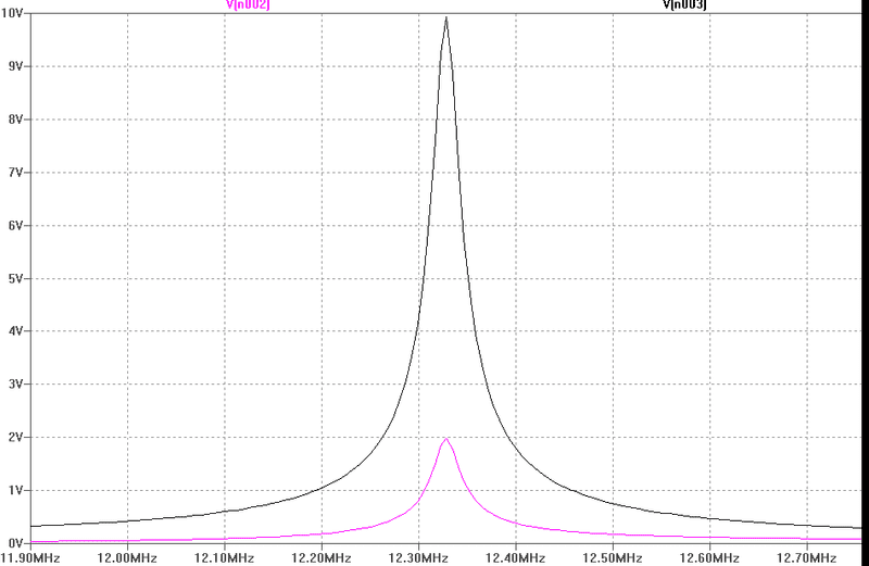

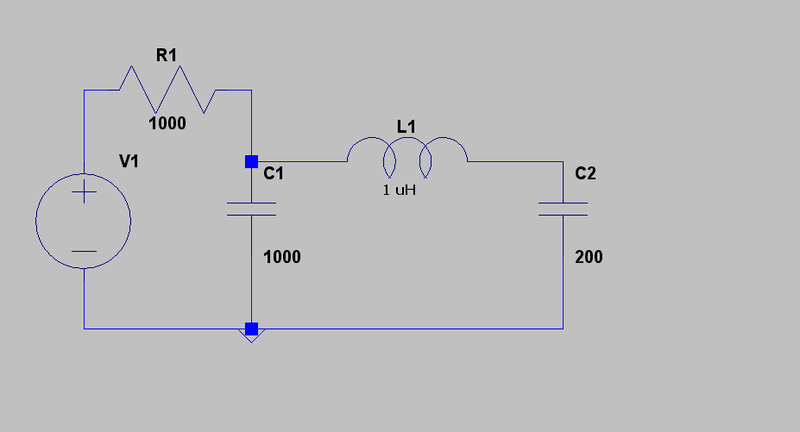

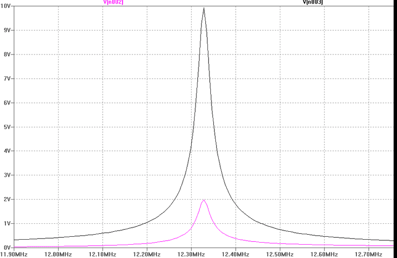

Just to show the effect of using tuned circuits like this, I did a simulation that shows the substantial voltage stepup you can obtain:
The capacitor values are in pF. The signal generator at left is generating sinewaves with 2 volts amplitude.
This is the result. The purple line is the voltage across C1. The black line is the voltage across C2.

Wow, that's pretty cool. Good idea, I should probably explore some of these simpler circuits in the simulator.
So am I correct in thinking this C1 in your diagram is equivalent to the C1 + C2 series capacitances in my circuit? Thanks a bunch for your input.

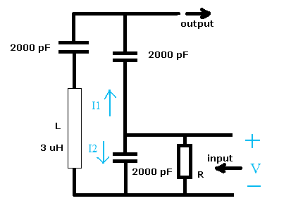

I put in this circuit:
into the simulator

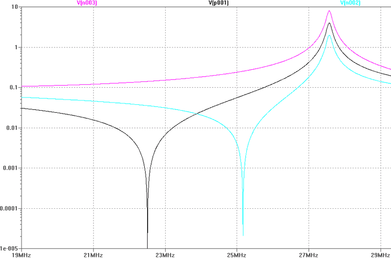

And got this output:

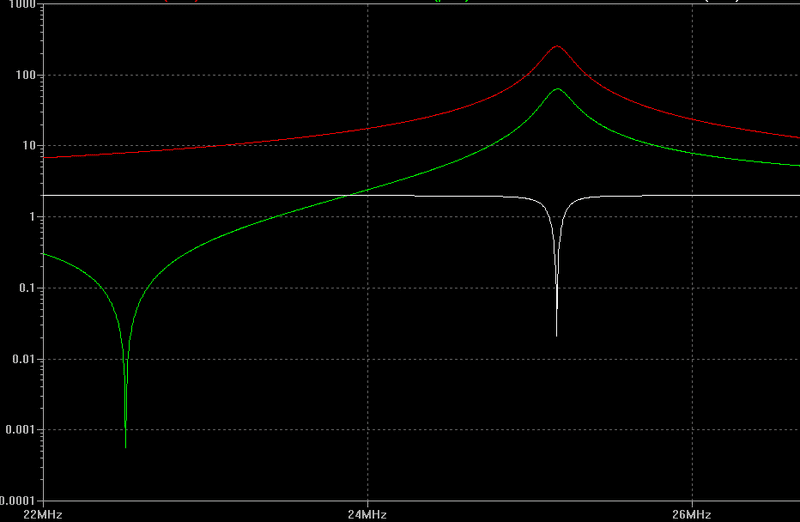

I have shown a logarithmic plot to show the sharp series resonances at the left.
The main output is at about 27.5 MHz.
Blue is across C1. Black is between C3 and L1. This would be the gate of your FET.
Purple is across C2
C2 has to be smaller than C1 and C3 to get a voltage stepup at the gate.
Lowering the impedance of the signal generator to 1 ohm (which would be more like the source follower output in your oscillator) gives a classic series resonance:
Note that output of nearly 300 volts across C2 for a 2 volt input. C1 is effectively shorted out. The green plot would be your gate voltage.
