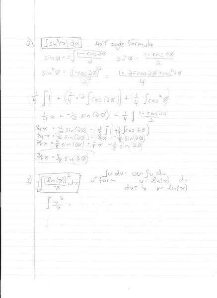

This assignment it kind of important, especially as the class is coming to an end. If I could get any of these problems checked I would greatly appreciate it. As you can see I am having some trouble on #3.
Thanks.

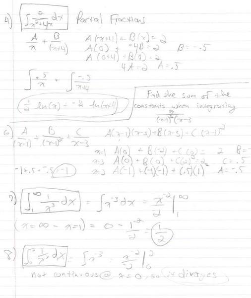

3) Just let ln(x) = u, then du= (1/x) dx and the integral is just [itex]\int u^2 du[/itex]
7) is correct but set out extremely poorly. (x= infinity - x=1)??
8) You have the correct reasoning on the second line, the first line is the working for a different question, [itex]\lim_{a\to 0} \int^2_a x^{-3} dx[/itex]
10) I can see that's incorrect because when you differentiate your result, you get factors of pi that you didn't account for. Check it.
And in 2) between the third and fourth lines a cos^2(2*phi) magically changes into a cos^2(phi). There should be a 4*phi term in the answer.
