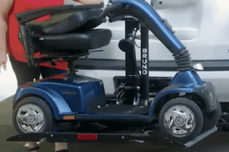

I got a lift which goes into the trailer hitch in the back of my car for my wife's scooter. Only problem it was made for a wheelchair. I found the extension arms so I only need to come up with the 4 cross bars. When I lift the unit, the tires of the scooter and the weight will sit on two crossbars in the front and the two crossbars in the back.
So the question: How thick would I need to have my four 1 1/2 inch steel flat bars which will be 28" long for them to carry the weight of the scooter which is 160 lbs?

We need a diagram that shows more details, such as what you mean by crossbars.
The extension arms are made for the weight so they are not a problem. The lift is also made for the scooter weight so it is not a problem.
If you look at the picture you can see the crossbars that come on the unit, that is if you buy it made for the scooter.
The only question is: does it need to be 1/4", 3/8" or what for the bars to handle the weight of the scooter without bending?

I see parts of dark things in the picture, some could be called crossbars, but my powers of remote mind reading, are unreliable.
Do crossbars go across the vehicle, or across the scooter?
What are they attached to, with what spacings?
Without a diagram, you are failing to communicate.

The bars will bend. There is no way around that. The only question is how much, and how much you can tolerate. That depends critically on how things are attached, and what the worst case load is - which may well be when you are putting the scooter on or taking it off and have an unbalanced load.
The bar bend is not your problem. Your problem is the attachment points. They are likely to yield long before the steel does.

Quiz: if you have a 3/8" bar attached by a 5/16" screw, which will yield first? (And do you really have only 1/32" of steel around the screw hole?)
No it would be a 1 1/2" wide bar by 3/8" thick

From the chassis of the vehicle, the structure will spread in stages, out to the load. It is unnecessary to make any one stage heavier and stronger, if the stages on either side are mismatched. To minimise cost and weight, we start analysis at the load, then migrate towards the vehicle.
The first step is where the tires of the load rest on the flat bars. If those bars are tight and have no sag, then the end connections of the flat bars will fail, the welds will crack. That comes about by the triangle of forces on each flat bar.
Once those bars are bent to reduce their tension, there comes the question of the front and rear members being pulled together by the load on the flat bars. Something must oppose that tension, and still attach to a vehicle connection. It seems the flat bars are an unnecessary addition, since the compressive component could support the load without the flat bars.

1/4" thick steel bar ( unknown elasticity so I used 65,000 ) over 28 inch length with midpoint load of 25 lbs. defect beam 0.25" but this is in a non supported free state. Neither end of the bar is welded.
I took and old 1/4" bar suspended it between two spaced blocks of equal height and placed the load at 14" midpoint, the bar deflected 1/4". Again neither end was anchored. I did same procedure with 2" wide 1/4" bar and got only 0.125" deflection, again not anchored.
Ranger Mike said:
... if we up the mid point load to 160 lbs. it deflects 0.080"
I was more concerned with the axial tension in the 1/4" thick bar, (the triangle of forces), and how that will distort the structure that supports it. If you minimise the deflection, you maximise the tension, and the damage to the frame when there is a vertical bump. The wheels need to apply the load directly onto the tubular frame, or be supported, hanging in deep catenaries.
If the wheelchair carrier has a rated weight capacity that will carry 160 lbs. then the 4 bars 1/4 thick will be more than enough if properly welded to the frame. If the carrier is for the true wheelchair and has only a 75 lbs., capacity you better rethink things.

you may be looking for an alternative solution. The Op is not. 1/4" bar vs 3/8 bar. go with 1/4-inch bar and weld it
