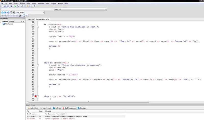

Alright I read your previous post and I tried but now I'm getting this
error: expected primary-expression before "else"
error: expected ';' before "else"

Again, I'll reformat your code:
Code:
if(number == 1)
   {  cout << "Enter the distance in feet:";
else
   if (number == 2)
      [color=red];[/color]
[color=green]{  cout << "Enter the distance in metres:";
}[/color]
else
   {  cout << "invalid";
In particular, your final else doesn't correspond to any previous "if". I assume that's what the compiler is telling you when it says
error: expected primary-expression before "else"​
although one of the later errors may be more indicative.
The mistake is the semi-colon marked in red: you surely did not intend for that to be your "then-expression". Instead, you wanted the green block to be the "then-expression".

Ive worked it out! Many thanks! :biggrin:
