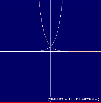

Hello,
I need to evaluate the following integral with respect to x. If you guys can give me some hints on how to start off, it would be greatly appreciated.
[tex]f{x}[/tex](x) = [tex]\int\frac{\alpha\beta}{4}e^{(-\alpha|x| - \beta|y|)}dy[/tex]
The integral is evaluate from -infinity to infinity
From this I know that [tex]\frac{\alpha\beta}{4}[/tex] is a constant and can be taken out. I get confused on how to integrate the absolute value portion of it.
Thanks!
I did some manipulation and am at the following part:
[tex]\frac{\alpha\beta}{4}[/tex][tex]\int e^{-\alpha|x|} e^{-\beta|y|} dy[/tex]
=[tex]\frac{\alpha\beta}{4}e^{-\alpha|x|}[/tex][tex]\int e^{-\beta|y|} dy[/tex]
To where you are now, evaluating the integral should be easy, noting that the remaining integrand is an even function.
Figured it out. Thanks!
Since this is an even function, we can just multiply the function by 2 and take out the absolute value because of symmetry and taking the limits of integration accordingly.
Therefore,
[tex]\frac{\alpha\beta}{4}e^{-\alpha|x|} * 2[/tex] [tex]\int e^{-\beta y} dy[/tex]
I have attached what this graph would look like as a function of x. There is symmetry about the origin and the graph is even, so this function is even. We can just multiply the function by 2 and evaluate the integral from 0 to infinity because of the symmetry.
=[tex]\frac{\alpha\beta}{2}e^{-\alpha|x|}[/tex] [tex]\int e^{-\beta y} dy[/tex], evalualted from 0 to infinity.
This integral evaluates to:
[tex]\frac{\alpha\beta}{2}e^{-\alpha|x|}[/tex] * [tex]\left(\frac{-1}{\beta}e^{-\beta y}\right)[/tex] evaluated from 0 to infinity.
[tex]e^{-\infty}[/tex] = 0
[tex]e^{0}[/tex] = 1
[tex]\frac{\alpha\beta}{2}e^{-\alpha|x|}[/tex] * (-1)(0-1)
Hopefully I did this right! :smile:
