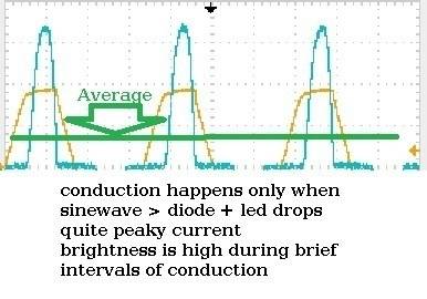

here's my guess
average responding, RMS indicating
persistence of eye makes it look brighter than it really is
I think you are correct Jim. When I hooked up my scope it indicated a DC voltage of around 2.5 VDC and a pulse wave more or less like your diagram.
In any event the circuit works like I have it designed. The less current draw the better.
Billy
presumably you saw the voltage across LED
should resemble the yellow line
current would resemble the blue one , methinks
glad to hear you're getting handy with the 'scope !

If the current is not steady, which it is not, (half wave) how would a digital meter (DMM) display that sort of current? What would it read if it was pure DC, in other words I assume the DMM would show a higher current reading with pure DC. Also if I built a full wave rectifier would the current not be twice a much and or display differently?

well sure it would be twice as much, you'd get twice as many current pulses 120 per second instead of just 60. Think simple.
You already know that answer - if you added a big filter capacitor , what would that do to voltage waveform ?

Planobilly said:
I also need to study a bit about how a typical DMM arrives at current measurements.
measures the voltage across its internal shunt, likely on its lowest voltage scale 200 mv or so
If selected to DC it just reports the average so you'll get whatever is the DC component , the area under the curve,
if selected to AC it somehow rectifies before reporting the result
if a "true RMS" meter it actually squares , averages and square roots,
but most are "average responding" which means they just rectify then average then multiply by .707/.636 to convert from average to RMS on assumption it was a sinewave.
