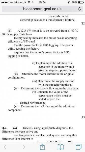

Hi there. I am wondering if someone can help me.. Below is a question and answer, I need help with IV . Where does the 0.51 and 0.28 come from? I've tried cos and sin and thitha but doesn't give me correct number

Seriously? You ask people for help by posting a tiny unreadable image of something
Cant you enlarge it by opening the actual picture? Sorry but I am new here..
The "enlargement" is tiny
The issue is not about this forum it's about the size of the image you posted.
A 12.5 kW motor is to be powered from a 440 V, 50 Hz supply. Data from
factory testing indicates the motor has an operating efficiency of 85% and
that the power factor is 0.86 lagging. The power utility feeding the factory
requires that the motor’s power factor is 0.96 lagging or better.(i) Explain how the addition of a capacitor to the motor would give the required power factor.
(ii) Determine the motor current in the original configuration.
(iii) Determine the supply current with the capacitor in place.
(iv) Determine the current flowing in the capacitor.
(v) Calculate the value of the capacitance which must be added to give the
desired performance
(vi) Determine the ‘VAr’ rating of the additional component.

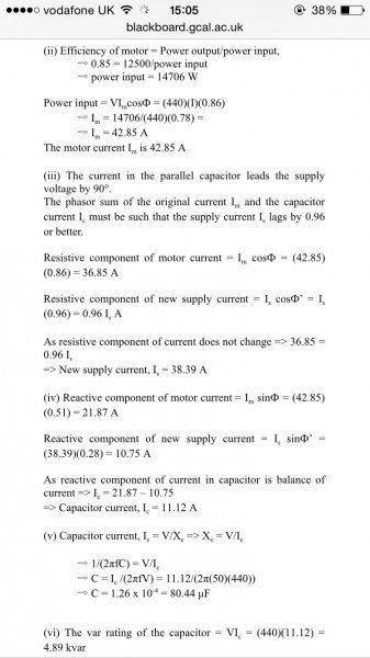

(ii) Efficiency of motor = Power output/power input,
ð 0.85 = 12500/power input
ð power input = 14706 WPower input = VImcosФ = (440)(I)(0.86)
ð I am = 14706/(440)(0.78) =
ð I am = 42.85 A
The motor current I am is 42.85 A(iii) The current in the parallel capacitor leads the supply voltage by 90°.
The phasor sum of the original current I am and the capacitor current Ic must be such that the supply current Is lags by 0.96 or better.Resistive component of motor current = I am cosФ = (42.85)(0.86) = 36.85 AResistive component of new supply current = Is cosФ’ = Is (0.96) = 0.96 Is AAs resistive component of current does not change => 36.85 = 0.96 Is
=> New supply current, Is = 38.39 A(iv) Reactive component of motor current = I am sinФ = (42.85)(0.51) = 21.87 AReactive component of new supply current = Is sinФ’ = (38.39)(0.28) = 10.75 AAs reactive component of current in capacitor is balance of current => Ic = 21.87 – 10.75
=> Capacitor current, Ic = 11.12 A(v) Capacitor current, Ic = V/Xc => Xc = V/Icð 1/(2πfC) = V/Ic
ð C = Ic /(2πfV) = 11.12/(2π(50)(440))
ð C = 1.26 x 10-4 = 80.44 μF
(vi) The var rating of the capacitor = VIc = (440)(11.12) = 4.89 kvar
Old PF is cosФ = 0.86 = arccos(0.86) = 30.68° so the sin of 30.68° degrees is sin (30.68°) = 0.51
Since the new PF must be equal to cosФ = 0.96 = arccos(0.96) = 16.26° so the sin of 16.26° is 0.28.
