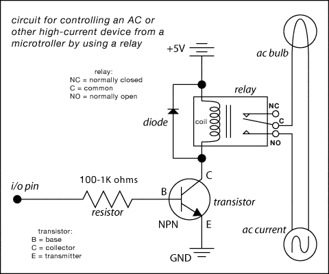

Please look at the attached schematic and give me your opinions if it would serve as power factor behavior monitor. If this is applied, I can simplify several amperes load, to this single small board, fed by a 220/50VAC transformer, that results would look obvious on PIC circuit, and hence on the clamp-meter. The highlighted compensating cap, is there to be installed and removed and to see equivalent circuit (pf) behavior.
if i understand , you intend this to be a test load for your pic power factor application?
Should work fine provided R1's 10M means ten milli-ohms not megohms..
If you move R1 down into the ground leg it'll be a current sampling resistor that you can observe safely with a grounded oscilloscope.

In your test circuit ?
I'll assume that 10M is ten milliohms. Makes no difference if it's more, that'd just reduce voltage across the reactive branches.
XL of 50 mh at 50 hz = 2πfL = 15.7 ohms
i see 4.7 ohms of resistance in series with 50 mh of inductance,, 4.7 + j15.7 ohms = 16.4∠73.2°
At 50 volts ohm's law says that'll pass 3.05 amps(call it 3) at 73.2° lagging
real component of current is 3cos73.2 = 0.87 amp
imaginary is 3sin73.2 = 2.87 amps
Of course you'll measure and add in the DC resistance of your inductor and repeat calculation... And make sure your inductor has enough volt-seconds to handle 50 volts...
to get to unity pf your compensating capacitor needs to draw 2.87 amps
at 50 volts that'd be 50/2.87 = 17.4 ohms of XC
C = 1/(2πfXC) = 183uf

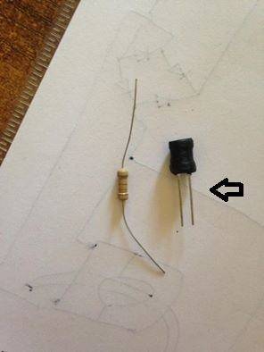

Please I didn't have found any inductor but this small one (at the right of the resistor, the purpose of putting a resistor in this image is to let conclude smallness of inductor).

What is the voltage across 50mh for 3 amps at 50 hz?
Are you familiar with inductor ratings? Volt-seconds ?
http://ecee.colorado.edu/copec/book/slides/Ch15slides.pdf
Your little inductor does not look big enough to handle the required flux.
Let's just guess that for a 50 volt 50 hz sinewave the gray area in that graph would be
λi = 50volts X √2(rms to peak) X 0.636(peak to average) X .01sec(half-cycle at 50hz) = 0.45 volt-second
that's going to be a physically big inductor
What would be λi for your 50 mh at 3 amps 50 hz ?

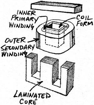

Following is the secondary of a 220/50VAC transformer:
This is the intended choke to be used as a load, when fed by a 50VAC source. The problem is that I don't know its Henry's value, and no inductance function exists in my multi-meter.
How can I know its L[H]?? Beside impedance changing, what are the consequences if its L is too below or too large than 50mH?
What are you notes about this? Should this translate uploaded circuit to a real connection? Is this true?
Thanks

firstly as to inductance of secondary
Formula for inductance windings around a closed magnetic path like a transformer core
is L = μμ0N2Area of core / length around path

Sometimes transformers that look like this
have underneath that sheet metal wrapper a core that looks like this,
http://www.rfcafe.com/references/po...nsformer-october-1960-popular-electronics.htm
(an interesting little article there, by the way)
you can see how easy it would be to place a thin spacer between the E and I shaped pieces and measure resulting inductance change..
You could wind your own coil, too.

Let me ask you at the moment about a switch, driven by PIC, that connects/disconnects caps according to code.
Popular one, is about Open-Relay Switch, but it is cored on Relay, that in turn have mechanical moving part.
I want to get rid of motion in switching, and referring to a solid-state device. the ULN2003 is a solid-state device, but its problem is that it doesn't connect load at full cycle.
What I want is a solid device, functions just like an open-relay without moving parts.
Any suggestions?
Following is a schematic for open-relay switch:

when you read that Crydom link
look at the 'zero crossing' variety of SSR's. They'll be gentle on your caps.
