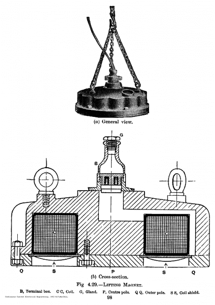

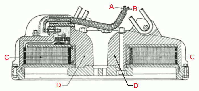

good wiki article here
https://en.wikipedia.org/wiki/Electromagnet
it gives a link to the 1914 book where that drawing came from.
But the examples there are in cgs units., the ancient ones i learned on .

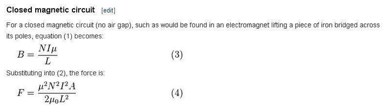

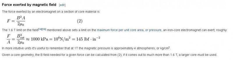

From WIKI
so leaving some headroom that dictates at least 10 square inches of magnet pole area for every 1000 lbs.
Force is in Newtons and a pound is 4.45 Newtons
N and I are the number of turns and your amps
A is area of the electromagnet core in square meters, and a square inch is only 0.000645 square meters
μ is the relative magnetize-ability of your iron. Garden variety steel should be a few hundred. 4130 is 190 at 60hz, will be somewhat higher at DC.
source:https://www.utexas.edu/research/cem/ESRDC_pub/PR 435 Wilder.pdf
μ0 is a natural constant, 4pi X 10-7
L is length in meters of your magnetic path, including the gap that'll be bridged by your work.
That's the physics you'll need to rough out a prototype design..
You'll need a few more amps than that formula says because the air gap is never quite zero.
I never built one of these - just that's where i'd start.

I maintain scrap magnet controllers. You are going to need to be careful with your controller if you are to avoid arcing and destruction of the internal wire insulation. Ask for more specific information about turning off your magnet once you know it's specs. It will be essential to provide a flyback diode.

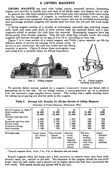

Attached is some data from my old archives.
And then there are more;
