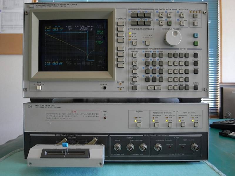

sophiecentaur said:
Someone may well post another more modern method but I'd bet the equipment would cost you a bit!
Yep. This is how we do it in our lab. Use the bias voltage feature of the old HP 4194, and be sure to calibrate it beforehand if you want to be measuring small capacitance values...
http://www.geocities.jp/etm_llc/pub/Z_report/pic2/4194A_16047D.jpg

Ha ha. Like I said - it would cost a bit. hp equipment is nice stuff. It always used to impress me that different pieces of hp kit would actually agree with each other. I always reckoned that there was some sub-ether comms between all hp instruments so that they could all get their stories to agree.
For home measurement, the best that most of us can hope for is a socket on a DMM for component measurement. Near enough for Jazz mainly.
