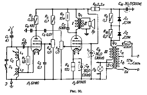

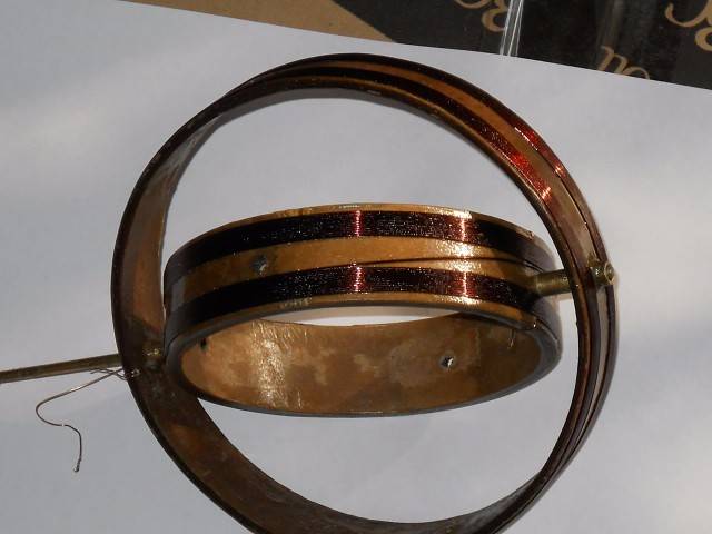

Many old amateur radios were coil-tuned, without any variable cap, like this (note the regeneration):
The "L1" inductor is rotating inside the "L2" like this:
- to me, it's even more fun than a variable capacitor . . .
There is a big advantage: You can connect the outdoor antenna via a long coaxial cable, thus avoiding the indoor electromagnetic noises. The cable capacitance then participates in the input LC without reducing the tuning range.
There is a big advantage: You can connect the outdoor antenna via a long coaxial cable, thus avoiding the indoor electromagnetic noises. The cable capacitance then simply works as the input LC capacitance without reducing the tuning range.
Pretty, in fact mind-blowing, but perhaps a bit unwieldy for a table-top radio :smile: . Did or would this kind of tuning work at 550-1600 KHz and without an external antenna?
rude man said:
would this ... work at 550-1600 KHz?
Yes that circuit was exactly for those frequencies, when without the C2.
But the tuning coils themselves did not work as antenna, they typically were placed inside the metal box:

AlexCaledin said:
Many old amateur radios were coil-tuned, without any variable cap, ...
A rotary variable coupler or transformer is called a "variometer". It can be used as a variable inductor by connecting the two coils in series. It can then give a very high ratio of maximum to minimum inductance. Variable capacitors cannot achieve such high ratios.
https://en.wikipedia.org/wiki/Transformer_types#Variometer_and_variocoupler
