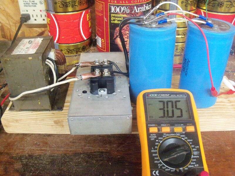

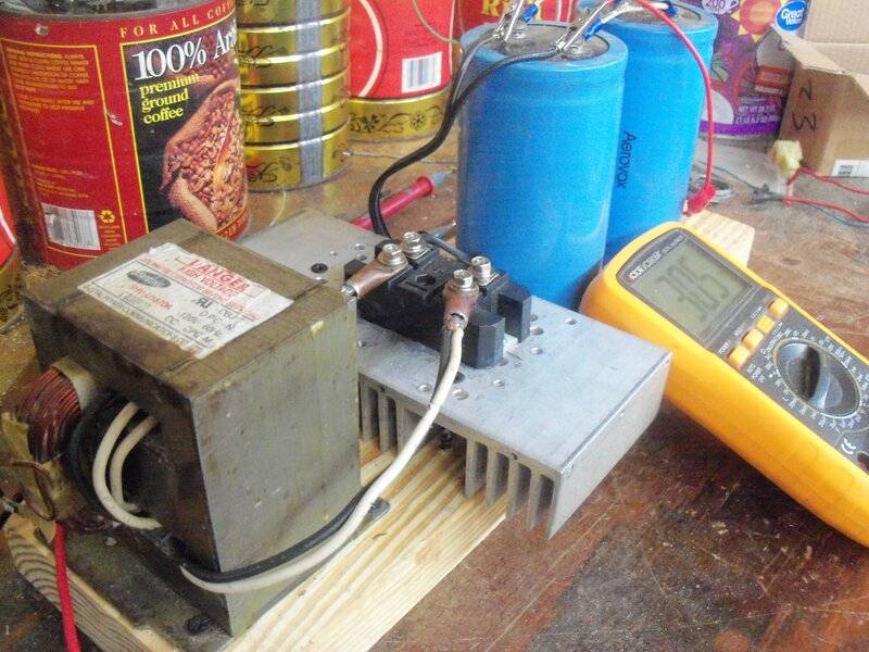

I made a 3 turn 60a secondary winding voltage is too high so I changed it to 2½ turns secondary is 3.05 vdc. Perfect. Primary is 120vac the transformer has warmed up 10 degrees after a few minutes of testing. Next I need a thermo switch on the 120vac primary then let it run for several hours to see how warm it gets. When I finish the circuit and put a 50a load on the transformer it might get hotter. I need to check DC output with a scope. I used these 2 caps because they were right in front of me. I have 100s of caps I might be able to find 50,000. uf for 3 vdc. I have a heat sink fan also it might be needed when the circuit is running 50 amps.

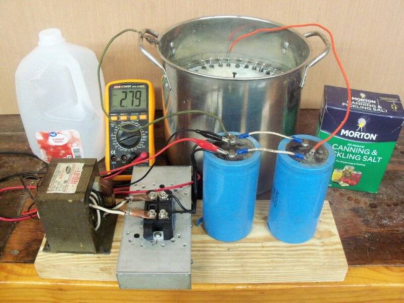

After 30 minutes the MOT transformer is almost too hot to touch. With 120 vac on the primary the amp meter shows almost no amps. With load on secondary meter is 2.80 vdc 2 amps = 5.6 watts. 40 carbon rods in salt water should have .2 amps on each rod but they don't. I need a transformer 30w 120vac to 3vac.

Where? Which current?
I'm not sure exactly what you're doing, but why do you need those big capacitors? They're going to cause more heat in the wires and diodes because of the reduced conduction angle (high peak currents). My ancient car battery charger doesn't have them.

This project is suppose to be 50a at 3v. Your suppose to use 1000uf per amp = 50,000. uf. Carbon rods have a surface of about 1 sq inch. Carbon rods are suppose to be .2a per sq inch. 40 carbon rods are 40 sq inches. 40 x .2 = 8a. I don't have enough carbon rods to do 50a. I tried a different DC power supply it is 12vdc and volt meter show the voltage across the salt water is up to 3.4 vdc. Voltage has come up from 2.8v to 3.4v. According to my test a 24v power supply should read 6.8v on the salt water. Tomorrow I replace power supply with a 1500w variac on 120 vac then dial in 8a on the salt water that should work. Data I have says to keep carbon rod at 3.5v .2a to prevent the rods from self districting. Data I have tells the voltage and amp but not how to build the power supply to get that. Variac should make it possible to dial in 3.5v 8a. I tested the resistance across the salt water cell and the carbon rods my meter shows 1.6 ohms. Tomorrow I do more tests and take more voltage and amp reading. I have 4 lbs of pure salt dissolved in 10 lbs of distilled water.

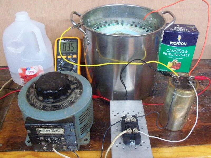

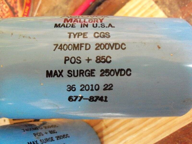

Problem solved 1 of the blue caps was bad. I learned 3.5vdc works but 3vdc does not, a 2kw variac connected to 120vac is working good. Amp meter reads 12a at 3.5v = 42 watts. All wires had to be changed to 15a wire. 40 carbon rod electrodes at the anode. Stainless steel pot is the cathode.

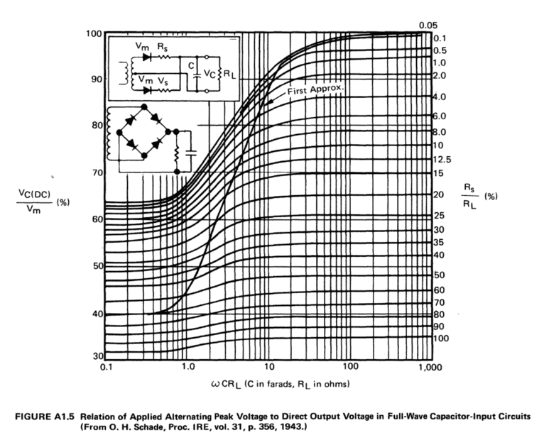

Check out the link I gave in post #14. Which includes this, among other useful stuff:
Graph titled Relation of Applied Alternating Peak Voltage to Direct Output Voltage in Full-Wave Capacitor-Input Circuits, plotting Vc(DC)/Vm in percent against omega C R_L on a log scale, with curves labelled by Rs/RL percentages from 0.05 to 100.
These values are best designed, not chosen by someone else's rule.
Case in point: I'm still not sure why he needs a capacitor at all.
