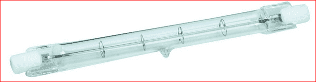

but it would be a lot cheaper to use an everyday 500 watt 120 volt halogen lamp, like those used in torchiere floor lamps.
http://www.homedepot.com/p/Philips-...ded-4-7-in-Light-Bulb-2-Pack-415729/202800575
you could buy a socket in the lamp parts section of your hardware store, or peruse local yard sales and curbside rubbish piles for a whole lamp .

Incandescent lamps when cold have resistance about 1/10 of hot value
so inrush can be significant
a 500 watt 120 volt lamp should be around 28 ohms hot, 3 ohms cold
at 48 volts that'd be 16 amps inrush to a cold filament.

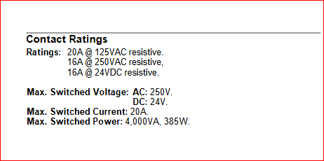

I just looked at the relay board i salvaged from a junkyard microwave oven, for a project
has a 12Volt power supply and a handful of relays on it.
Main relay contacts are marked 20 amps 120V~, 17A 250V~. coil is 12VDC. It's TYCO 0MIF-S-112LM
http://pdf1.alldatasheet.com/datasheet-pdf/view/228047/MACOM/OMIF-S-112LM.html
follow links to the datasheet
it should do the job. But it's not rated to turn the lamp off against your full 48 volts DC, so only use it for discharge duty when incoming power is off, or protect the contacts..
