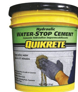

Small update: I found evidence of mice in my basement but couldn't figure out where they were coming in from. Then I crawled under my deck which has very low clearance and saw there is essentially a missing brick in the lower outside wall. Obviously that is how they are getting in and I wonder if that hole was contributing to my pressure issue. I mean literally there is a brick size hole leading into my basement. I never saw it from the inside because there is dry wall down there.
Well spotted ! Was there an old pipe or something before ?
Whatever, at this time of year, expanding foam is your friend...
