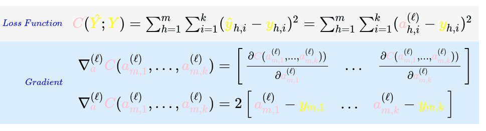

There are only slight differences between my formulas and the formulas found on the wiki page for backpropagation under matrix multiplication. Where I am calling the gradient of the cost function ##C## with respect to the input layer ##z##, or ##\nabla_{z}C##, the wiki page is calling just delta, or ##\delta##.
The main differences that I'm seeing between my formulas and the wiki page's formulas is the wiki page is using ##\nabla_{W}^{(l)}C=\delta^{(l)}(a^{(l-1)})^{T}## where I am using ##\nabla_{W}^{(l)}C=(a^{(l-1)})^{T}\delta^{(l)}##, and the wiki page is using ##\delta^{(l-1)}=(f^{(l-1)})^{'}\bullet(W^{(l)})^{T}\bullet\delta^{(l)}## where I am using ##\delta^{(l-1)}=(f^{(l-1)})^{'}\bullet\delta^{(l)}(W^{(l)})^{T}##.
I think the reason for the slight difference in the formulas, is because the wiki page is doing a special case of row-wise backpropagation, where I am doing backpropagation on the entire data set at once.
In the wiki page, ##\delta^{(l)}## is a vector, which is most likely the error of a single example in the data set, but I am having ##\delta^{(l)}## be a matrix, which is the error term for all of the data in the set. Is it not possible to do backpropagation on all of the data at once? It's intuitive to me to do backpropagation on all of the data and make ##\delta^{(l)}## a matrix, because the loss function ##C## is a function of all of the data. In my model, the loss/cost function is ##C(\hat{Y};Y)##, where the model output ##\hat{Y}## and the target matrix ##Y## are both matrices. So, taking the gradient of the loss/cost function must also be a matrix, right? How could it be a vector? And what would be the point of separating the data into batches if the gradient is being computed for each row at a time?

He seems to be applying the gradient descent row-wise, or treating ##\delta## as a vector instead of a matrix, which I don't understand. He used batches, yet, splits each batch into vectors, so it doesn't make any sense to me.

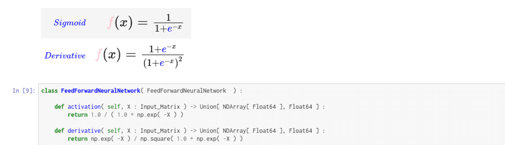

One thing that I noticed is that your derivative code doesn't match your math.
The math is showing the gradient applied to the ##m^{th}## example. The code is applying the gradient to the entire input matrix. At least, that's what I think it's doing.
O you meant for the activation function. I believe I made a typo in the math. Good catch.

Yea. It might be a little confusing, but I'm not using lists to store the weights and biases. I'm using two dictionaries with keys that are integer values. The keys are the layer numbers. The input layer is the zeroth layer and does not have any weights or biases. Hence why there is no weights[0] or biases[0].
I decided to use a dictionary, because it's easier to populate and repopulate. Also, the math I derived is treating the input layer as ##l = 0##, and the output layer as ##l = number\ of\ hidden\ layers + 1##. So, I wanted to follow that convention.
Also, when storing the weighted input of each layer ##Z## and the output of each layer ##A##, it is easier to follow mathematically if they are dictionaries with layer number as keys. That's why I decided not to use ##i## in the for loops.
So, there are no lists in this program lol, except for the keyword argument "hidden_layer."

I'm almost positive it's a mathematical error, now. I suppose using dicts with interger keys may be a little confusing, but it follows the math notation, so I'll prob stick to it until the program actually starts working. Then, maybe I'll go in and change the dicts to lists. Maybe I'll include an input layer into the lists of weights and biases, so it will still follow the math notation.
For now, I have to compare the math that I derived and used with other sources. Hopefully, I find another source that is also treating ##\delta## as a matrix, instead of a vector, or at least one that explains why ##\delta## should be a vector and not a matrix.
The strange thing is that the program does minimize the cost function, or at least seems to minimize it. Somehow, it achieves a model with a smaller cost than what the SkLearn module produces. However, the output is complete nonsense. It's just a matrix of identical vectors, and every vector is composed of nothing by zeros. Somehow, this is a better model, according to the sum of squared residuals.
I am applying the model to the MNIST training set, which is composed of 60,000 training examples. My erroneous model achieves a cost of 59,999, which makes sense if it outputs a matrix of nothing but zeros. I don't think it's an issue of overfitting, because if I decrease the training time or number of iterations, the cost goes up and it still outputs a matrix of identical vectors. The SkLearn models cost is typically around 70,000-100,000, but are actual working models.
It's kind of funny that a nonsense model that outputs nothing but zeros is a better model according to the cost function lol. wish this were just an issue of over training, but it's not. I'm convinced the math is wrong.
