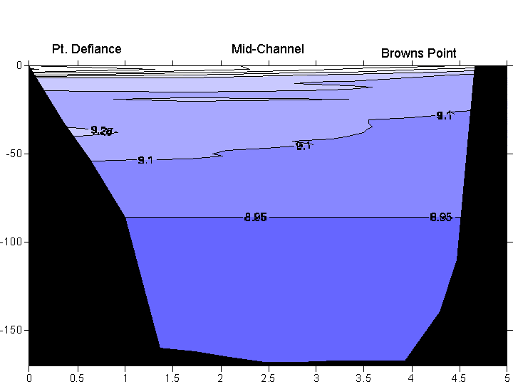

http://courses.washington.edu/uwtoce05/webg1/results.html
Are you talking about the turbulent mixed layer near the surface? That is average behavior. I don't believe that back of envelope calculations can capture the complexity of real life like in the link and picture above.
Those submarine designers put the DC tanks in for a reason.
I also know from swimming in the same places day after day, that the depth of the thermocline rises to less than a foot on some days and that its depth can change in less than an hour. Can your calculations show that?
I don't think so. I was thinking more of the average density profile as shown in this figure: http://www.windows2universe.org/earth/Water/density.html
For any given density profile, we can, of course, perform the calculation to quantify the effect of the variation in buoyancy between 5 and 20 meters in depth. What is your best estimate of the range in the difference in water density between 5 m and 20 meters, taking into account the possible range of salinity and temperature that might be encountered in practice?
