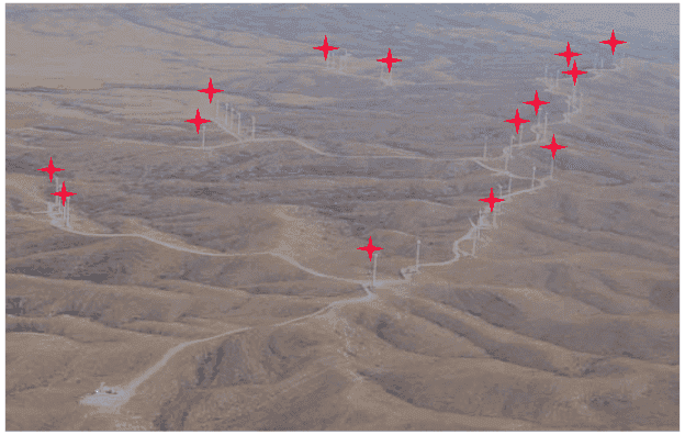

Imagine the view from above at night... synchronizing the lights makes it apparent where are the boundaries of the area to be avoided.
I've driven past those huge farms along I80 in Wyoming at night. You only have to see one cycle of the strobe to know how long is the string of windmills.
At the wind conference in Orlando last week the lighting manufacturers were showing off their new radar system that turns on the strobes only when it detects an aircraft in the vicinity.
http://www.nawindpower.com/issues/NAW1406/FEAT_05_Obstruction-Lighting-Advances-Make-Turbines-Better-Neighbors.html
A wind farm’s blinking red obstruction lights are a necessary safety measure to ensure wind turbines – which can measure from 400 to 550 feet in height – are visible to pilots and their aircraft. However, the intensity of these beams can also be an irritant to nearby residents, as the lights blink in contrast against the night sky. But thanks to advances in obstruction lighting technology, suppliers are introducing new products that flash only when necessary. The improvements are part of a growing trend to make obstruction lighting programs less intrusive.
and from
http://www.airporttech.tc.faa.gov/safety/downloads/TN05-50.pdf
I wonder how they synch all those lights? Any idea? An accurate timer?
Radio links? Master / slave flashing using a light sensor? Line freq. to synch?

Jimster41 said:
For some probably idiotic reason there are huge FAA type signal lights on top of each one. And they all blink on at once. We pondered and pondered how this is achieved, and the why.. but the effect at night is... frankly hellish. I couldn't live with it. Good only if you wanted read a book to Satan, three words at time.
@Jimster41
Maybe this extract from the FAA Study explains why those lights have been fitted so bright & annoying.
"Nighttime wind turbine obstruction lighting should consist of aviation red-colored lights, either flashing or steady-burning, only. Minimum intensities of 2000 candelas for nighttime red flashing or strobe lights (L-864) are required. The standard FAA L-810 steady-burning obstruction light, with an intensity of approximately 32 candelas, is of very little use."
The wind turbine warning lights seem mandated to be approximately 60x as bright as a regular obstruction light for aviation.
I wonder why this rule is so?
