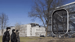

mfb said:
Another concept
They all don't look very efficient. And this one even needs water.
from their link:
A mixture of 30% ethanol and 70% demineralized water appeared to be the most suitable spraying liquid.
It'll be perpetual happy hour downwind ! Got juniper ?

These too are bladeless wind electricity generators. What kind of mechanism is used here? That should be different from what mechanism used on pole generators.

I like the one that looks like a cell phone. I assume it's a version of mfb's electrostatic generator.
I like it because it could be placed in fields and potentially used to irrigate crops or possibly in a water park as an artistic feature. In the southwest it might be used as a house cooler. It looks like it could be a nice, dual use generator.

HyperTechno said:
View attachment 85193 View attachment 85192 View attachment 85191
Can someone please explain the mechanism of the wind electric generators that I've shown in my previous reply?
  • #71
That would be a lot easier to do from a link than from just a photograph.
Anyway, the second and third photograph have already been discussed here (saphon and ewicon)
  • #72
Ok, I'll read that. Thanks.
  • #73
The first one is a conventional turbine, just floating in the air. I don't remember which company made that illustration.
