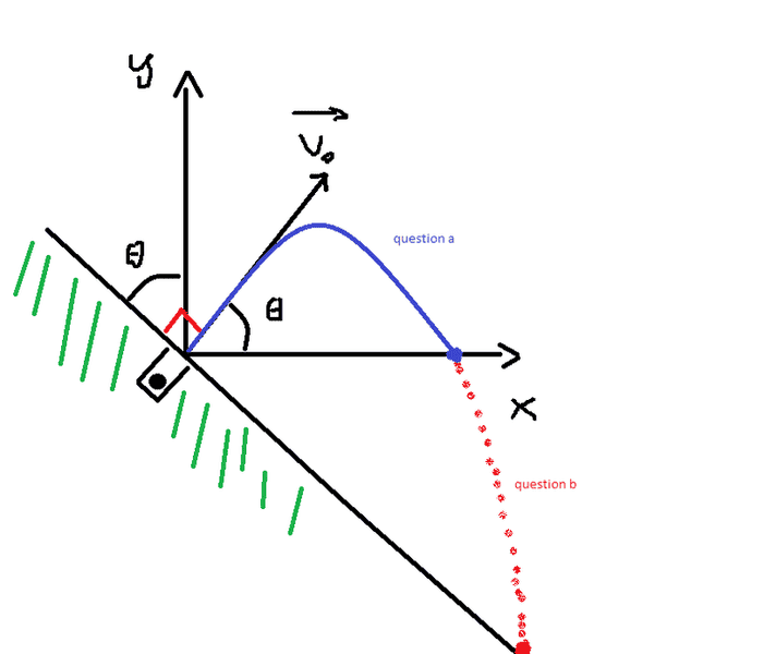

A canon is burried on a hillside, so the barrel is exactly at the height of the surface. The hillside creates angle theta with vertical, where 0 degrees < theta < 90 degrees. A canonball is fired with speed v_0 perpendicular on the hillside. The angle between velocity_0 and horizontal also has angle theta. g is 9.8 and there is no air resistance.
a) Find the vertical distance from the firingpoint to the point where the canonball again has the same height as when it was fired.
b) Find the horizontal distance from the firingpoint to the impact location on the hillside.
Hand-drawn diagram of a projectile launched from a slope: x and y axes meet at the launch point on a hillside line at angle theta to vertical, with velocity v0 drawn at angle theta above the horizontal and a right-angle marker showing the perpendicular to the slope.
This is the exact text translated from my language. And sorry about my lack of paint skills.
How am I supposed to find the distance when I have no variables?

You are told that the hillside makes angle [itex]\theta[/itex] with the vertical which means it has angle, as in your picture, [itex]-\theta[/itex] (radians) with the horizontal. If we take the position of the barrel of the cannon to be (0, 0) in an xy- coordinate system with the y-axis vertical and x-axis horizontal we can write the equation of the line, as shown in your picture, [itex]y= -tan(\theta)x[/itex]. The cannon ball is fired perpendicular to the hillside so at angle [itex]\theta[/itex] to the horizontal, as you show. The x and y components are as you give, [itex]y(t)= -(g/2)t^2+ v_0 sin(\theta)t[/itex] and [itex]x(t)= v_0 cos(\theta)[/itex]. You want to find the point where the two graphs intersect. Replace the x and y in [itex]y= -tan(\theta)x[/itex] with [itex]y(t)= -(g/2)t^2+ v_0 sin(\theta)t[/itex] and [itex]x(t)= v_0 cos(\theta)[/itex] to get a single quadratic equation in t. Of course, one of the two solutions will be t= 0.

1] vertical distance is from the initial point and to the point where it impacts the x-axis again. So a normal parabola with initial velocity and angle. that is what question (a) is about.
2] Then question (b) is where the projectile impacts the hillside when it goes under the x-axis.
Im sorry if my question is confusing, but I just translated the text in the assignment.
Also I have changed the picture to add the two parabolas hopefully helping, though they were not on the picture giving with the assignment.
b
Diagram of a projectile launched up a slope at angle θ from the horizontal, with velocity v0 and axes x and y; blue arc labelled question a lands on the x-axis, red dotted path labelled question b hits the slope.

In that case, it looks like you have part (a) solved.
For part (b), define your points on the hill as pairs (x, f(x)) and do the same for your position function. I mean change t into a function of x, and use that in your functional form for y(t) to make y(x).
Then you should be able to 'generally' solve for where the curves intersect.
