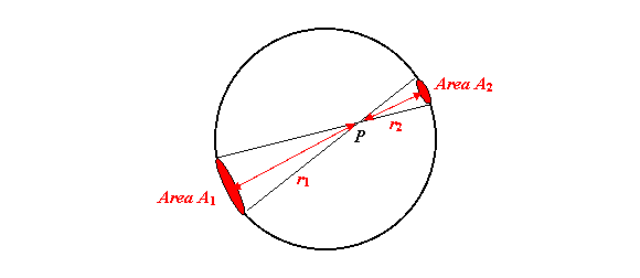

"The reason why gravitational force vanishes inside a spherical shell can be seen by a simple argument due to Newton. Consider the two small mass elements marked out by a conical surface with its apex at ##m##.
The amount of mass in each element is proportional to its surface area. The area increases as (distance)2. However, the strength of the force varies as 1/(distance)2, where the distance is measured from the apex to the shell. Thus the forces of the two mass elements are equal and opposite, and cancel. We can pair up all the elements of the shell this way and so the total force on ##m## is zero."
Are the cones similar because of the spherical symmetry of the shell?
Yes, in a word, it is due to symmetry.
In a few more words:
Consider a 1 Kg mass at point P some distance inside the spherical shell, not at the center.
Circle with a point P inside it, two thin cones drawn from P to opposite arcs labelled Area A1 and Area A2, with distances r1 and r2 marked from P to each area.
Area A1 = θr1^2, for thickness t Volume = θr1^2t, Mass = θr1^2tp
The gravitational Force exerted on the 1 kg mass by this section of shell is
F = G(θr1^2tp) / r1^2 = Gθtp
Using the same method the mass at Area A2 = θr2^2tp
F = G(θr2^2tp) / r2^2 = Gθtp
The gravitational forces are exactly equal and cancel out and this holds true for all of the outer shell material taking all of the forces in pairs.
But be careful to note this only applies to a spherical shell. Inside a solid sphere there is also a solid inner sphere that will exert a gravitational force on the object that varies with the distance from the center. But if that point is exactly at the center so that there is no inner sphere then the total gravitational force is zero.

So the area of the spherical segment is ##r^2 \theta##?
Also, what is the gravitational force experienced at ##r = R## (for a thin shell of radius ##R##)?
Yes but keep in mind that θ in this case is the solid angle, measured in steradians. Since the surface area of a sphere = 4πR^2 you can deduce there are exactly 4π steradians of solid angle in a sphere.

I was referring to the drawing I posted earlier, in which case the distances r1 and r2 are not measured from the center of the sphere but from the object inside the sphere to the outer shell. In that case, when r = R the object is at the center of the sphere. When stating any measurement, point of reference should be clearly stated also.
