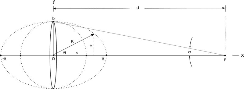

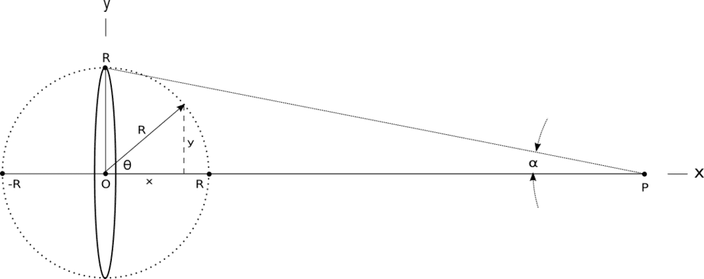

Start with the gravitational force from a disk centered at the origin, a distance d from the point P, as shown in the figure. The integration is standard and the force equals either equation:

where G is the gravitational constant, ##m## the mass at P, ##\sigma## the volume density of the disk, R the disk radius, ##d## the distance of P from the disk and ##t## (##= dx##) the disk thickness.
With the radius of the disk and the distance to P now a function of x, we make the following substitutions in the second equation and just integrate to get,
\begin{align*}
& 2\pi Gm\sigma[1 -\frac{{d-x}}{\sqrt{(R^2-x^2)+(d-x)^2}}]dx \\
& 2\pi Gm\sigma[\int_{-R}^{R}dx -\int_{-R}^{R}\frac{{(d-x)dx}}{\sqrt{(R^2-x^2)+(d-x)^2}}] \\
& 2\pi Gm\sigma[2R - (2d/a) \sqrt{ax+b}|_{-R}^{R} + (2/3a^2) (ax-2b)\sqrt{ax+b}|_{-R}^{R}] \\
& 2\pi Gm\sigma[2R - 2R + 2R^3/3d^2] = GMm/d^2
\end{align*}
Where ##a=-2d## , ##b=R^2+d^2## and ##M=4\pi \sigma R^3/3##

The equation for the ellipse is ## x^2/a^2 + y^2/b^2 = 1##, ##a > b##. Substituting ##a## for ##d## above and solving for ##y##, the equations become
\begin{align*}
& 2\pi Gm\sigma \int_{-a}^{a}[1 - \frac{(a-x)}{\sqrt{(b^2-(b^2/a^2)x^2)+(a-x)^2}}]dx \\
\text{or} \\
& 2\pi Gm\sigma \int_{-a}^{a}[1 - \frac{(a-x)}{\sqrt{Ax^2+Bx+C}}]dx
\end{align*}
with
$$A = 1 - b^2/a^2, B = -2a, C = a^2 + b^2$$
The gravitational attraction on the surface of the ellipsoid at point ##a## - which is all you need - becomes
\begin{align*}
& 2\pi Gm\sigma [x - (a + B/A)E + D/A]|_{-a}^{+a}
\end{align*}
where
$$D = \sqrt{Ax^2 + Bx + C}~~~~~ \text{ and } ~~~~~E = ln(2 \sqrt{A}D + 2Ax +B)/\sqrt{A}$$
which can be programmed.
