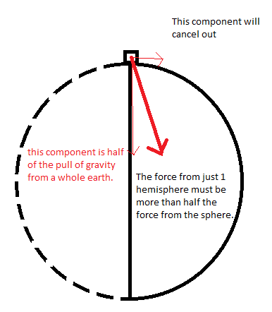

No, Standing at the north pole and slice the Earth along a meridian. Since the pull from the two halves together equals the pull from the whole sphere, The pull from each hemisphere must be larger than half, because the direction of the pull from a hemisphere is at angle. The vertical component of the force would be 1/2, but there would be a horizontal component as well, Therefore the total force from an hemisphere must be more than half of the magnitude of the force from a sphere.
The pull from the hemisphere has components in two directions - the pull in the third direction cancels out by symmetry.
The "vertical" pull is half the pull of a sphere. If you add another hemisphere, then the vertical pull doubles, but the horizontal pull cancels out.
Yes, That is what I said. My point is that the magnitude of the force from a hemisphere (by itself) must be more than half of the magnitude of the force of gravity from the whole sphere. It seems counter-intuitive, but the vector addition is pretty straight forward. That was the whole point of this thread.

You are making this too complicated. Just think of two equal point masses and, say, you are equidistant from them. The magnitude of the total force could be anything from 0 (if you are directly between them) to just less than the sum of the two individual magnitudes ( if you are far away).
If you take a sphere as a set of point particles, then much of the force from each particle (if you are standing on the surface) is canceled through symmetry.
The total magnitude is much less than the sum of the magnitude of each particle.
In fact, in proving the shell theorem the maths is simplified greatly by ignoring the symmetric cancelling forces.

It can't be less than half! Because then if you put two hemispheres together...
It can't be equal, because some of it is lateral.
It must be more.
Because gravity reduces as ##1/r^2## you can't appeal to centre of mass arguments, which are based on ##r##.
The shell theorem, in that respect, is a mathematical oddity.
