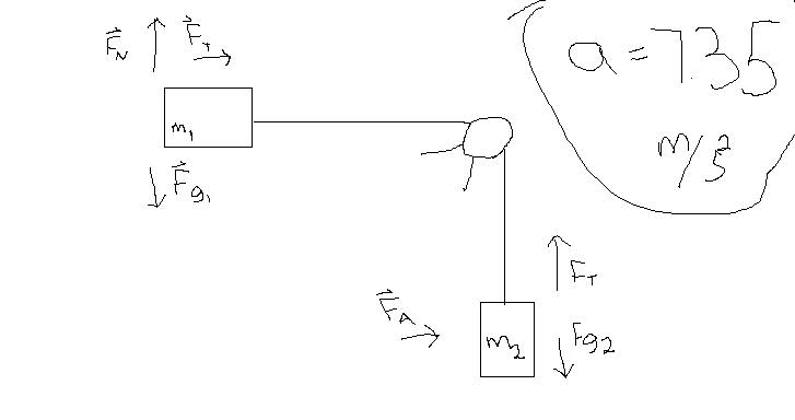

John (mass 80) rests on top of a light cube (mass = 0). A light rope passes horizontally from him over the front edge, and vertically down to Brian (mass 60kg) who hangs in contact with the front face as shown. The cube is on a horizontal surface and there is no friction anywhere. Joe (mas 70kg) has his back to a wall and applies a horizontal push perpendicular to the rear face. Calculate the value of the force, which will prevent both John and Brian from sliding over the surface of the cube.
Here is the diagram which i redrew from the book.

I drew a better diagram, because i now know what i did is wrong.
The acceleration is 7.35m/s^2.
I do not know where to go from here. I know Joe has to apply a force on the cube. I know that Brian (the hanging one) will accelerate in the same direction as the applied force. I don't know how to figure out how big this force has to be to prevent John and Brian from slipping off the cube.
Can anyone help me out, now that i have the correct acceleration?
The 7.35 m/sec^2 looks good because that puts enough tension in the cord to cancel the force of Brian.
To achieve that acceleration, the person standing on the ground would have to accelerate both Brian AND John at that rate. So what force would be needed if the block weighs nothing?

That would be 1029N.
Fun=140(7.35)
