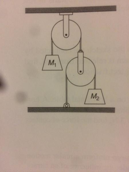

Masses M1 and M2 are connected to a system of strings and pulleys as shown. The strings are massless and inextensible, and the pulleys are massless and frictionless. Find the acceleration of M1.
Newton's 2nd Law of motion
So here is my line of reasoning. We have four objects with which we can use Newton's second law to derive relationships which will get us an explicit expression of the acceleration of block 1.
Newton's law for block 1:
##T_1 - m_1 g = m_1 a_1##
Newton's law for block 2:
##T_2 - m_2 g = m_2 a_2##
Newton's law for pulley with block 2:
##T_1 - 2T_2 = 0##
##T_1 = 2T_2##
Next, if we combine the equation for block 1 with the equation for block 2, and if we assume ##a_1 = a_2##, then we get,
##\displaystyle a_1 = \frac{g(2m_2 - m_1)}{m_1 - 2m_2}##
However, this is not the correct expression, because we must have that if M1 = M2 then ##\displaystyle a_1 = \frac{g}{5}##
Where am I going wrong with my reasoning?

a1 is not equal to a2. Think: the moving pulley sinks by dx, how much does m2 move?

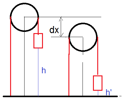

See the figure. If the pulley sinks by dx, the left piece of string becomes shorter by dx and the right one must become longer by dx. So the mass m2 moves downward by dx with respect to the pulley. But the pulley has moved downward by dx with respect to the ground, so the mass had to move by 2 dx downward with respect to the ground.

How would you derive this from the fact that the length of the string is constant? If we say that ##l = x_L + x_R + \pi r##, where r is the radius of the pulley, and the two x's are the left and right sections of the string, then if we differentiate twice we just get that ##\ddot{x}_L = - \ddot{x}_R##, which doesn't show that the rate at which the mass moves is twice the rate at which the pulley moves.
The acceleration is with respect to the ground. You need to differentiate h twice, instead of xr.
So is it something like ##l = h + \pi r + (h - d_g)## where ##d_g## is the distance of the block from the ground. So if we differentiate twice we get that ##\ddot{d_g} = 2\ddot{h}##, which means that the rate at which the block accelerates is twice the rate at which the pulley accelerates...?
Yes, and twice the acceleration of the other mass, only opposite direction.

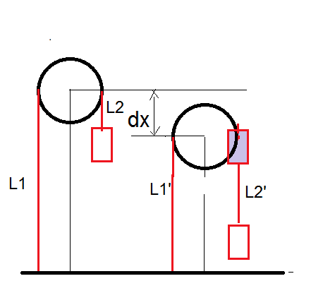

Do you get this from looking at the constant length of the other string for the other pulley?
Yes. Because of the length of the other string is also constant, and the left pulley is fixed, the accelerations of the hanging pulley and mass m1 are opposite and of equal magnitude.
