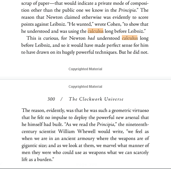

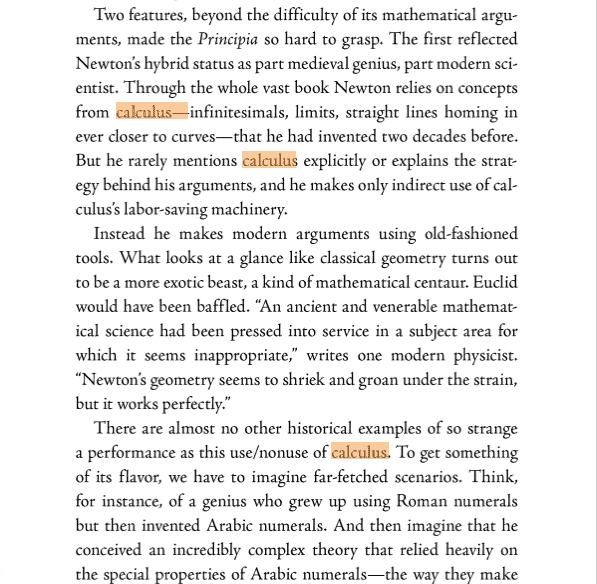

The "synthetic geometry" doesn't show up at all in these first preliminary chapters, Definitions, and Axioms, or Laws of Motion. It makes it's first appearance right after in Book 1. There isn't any 'synthetic geometry equivalent' of F=ma.
Also, no one "recognized" Newtons strange geometry as his calculus, because he hadn't published any of his calculus at the time.
I'm attaching three successive screenshots of a long passage from The Clockwork Universe which should alter your view of calculus in the Principia.
