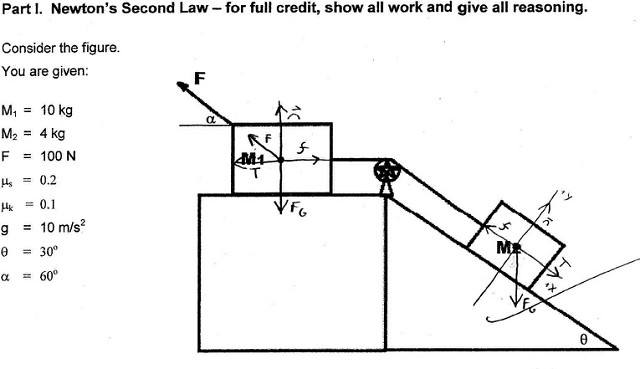

Handwritten free-body diagram of two blocks on a stepped surface: M1 on top of a block with force F at angle alpha, pulley at the corner, M2 on an incline at angle theta, with labeled forces Fg, T and normal axes, and given values M1 = 10 kg, M2 = 4 kg, F = 100 N, mu_s = 0.2, mu_k = 0.1, g = 10 m/s^2, theta = 30 degrees, alpha = 60 degrees.
This was a return of my test and I have filled in the forces already. I got a few problems wrong and I would like to see what the correct answers are.
1. Write an expression and determine the value of N1, the normal force acting on M2
2. Write an expression for and determine the value of the net force acting on the system.
3. Write an expression for and determine the value of the force (Tension[T2]) the string exerts on M1
4. Write an expression for and determine the value of the force (Tension[T2]) the string exerts on M2

1. N1=Mg-sin(α)=99.1
2. -30.18-.9-43.08=12N
3. T1=-Fcos(α)+Fs-sumFx1
T1=0
4. T2=sumFx2-mgsin(θ)+Fs2
T2=0
Sin[α] is a ratio of 2 lenght. Force unit is in Newtons.
