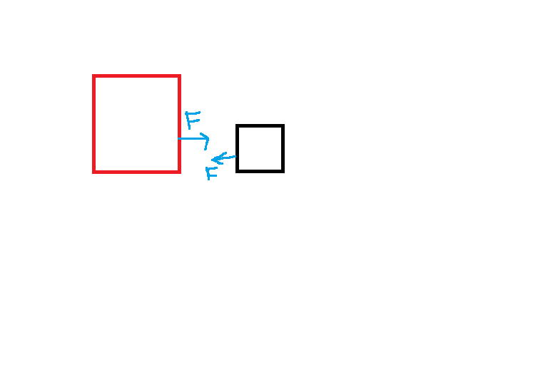

Hi Shayan. Draw the Free body diagrams first.
Assume the red block to be a cart and the black box to be horse (Just imagine:-p). I have mentioned the force acting on the horse and cart. I have not drawn normal and frictional force acting on the horse and cart. You can see that a ##net## force acts on the cart. That's why it moves.
shayan haider said:
You are saying that the Tonga is experiencing the greater acceleration, so it moves. But according to your answer, there is net acceleration which in turn means that there is net force on Tonga which can't happen.
Yes, it can happen. Why wouldn't it be able to happen? Third law pairs act on different objects.

Thank you. You are right. This simple because the forces are acting on two different bodies so they do not cancel each other. But according to MohammedRadey97 the less massive body would experience net force which means if cart is more massive then it would pull horse backward. I think so that there is some different explanation.

You seem to have more or less got this now. The fact is that N3 says nothing about Equilibrium and it's only when there are balanced forces (each with their own reaction force btw) that you get equilibrium and no acceleration.

The key is the force of the horse pushing against the ground. If you were out in space and pulled something with a rope, then you would move towards the object you are pulling as well as it moving towards you. By Newton's third law, both you and the object would experience the same force; and, by the second law, the acceleration of each would be proportional to the mass. So, if you pulled a more massive object, you would accelerate faster than it.
On the Earth, the horse is pushing against the ground with a greater force. This force effectively accelerates both horse and cart.
On the TV in the UK recently there was the "World's Strongest Man" competition. One test involves pulling a giant truck. To do this, the strongman must exert a huge force using friction on the ground (they all wear rock-climbing shoes as these have the greatest friction). Most of this force is transmitted to the truck through a rope, and the truck pulls back on the man, so there is only a small nett acceleration of both.
In short, there are two forces acting on the horse and only one on the cart.

Thank you. You have presented a logical explanation for this and cleared my confusion. I was also thinking of applying this law in space and imagined the same thing. Thanks again.
