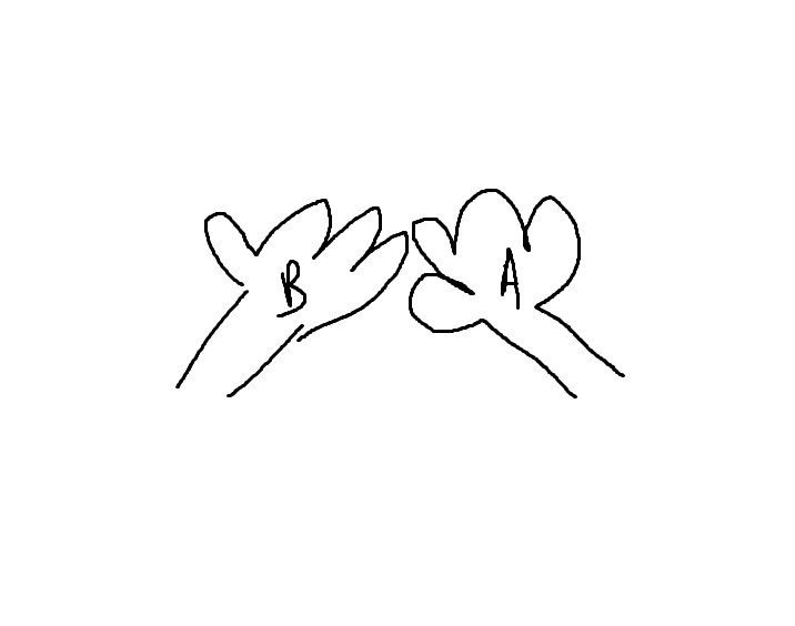

I am not the best at drawing, I know.
If A exerts a force of 200N on B, then by Newton's third law, 200N would be exerted on it. Similarly, if B exerts 100N on A, by Newton's third law, 100N would be exerted on it. Then why wouldn't both accelerate in opposite directions with accelerations equal to 300/ma and 300/mb respectively?

You exert either 100N or 200N and you then expect an acceleration as if you applied 100N and 200N together? But let that slide.
Edit: Perhaps you have a violation of Newton's third law in mind so that A pushes on B with 100N at the same time that B pushes on A with 200N. How is that supposed to work?
What about the rest of the picture? One imagines that hand A and hand B are both connected to the same person and that the person is pressing his hands together (with either 100N or 200N of force). That means that his arms are pushing his hands together. The F in Newton's second law is the net force on the object from all the individual forces combined. It is not the single force that happens to appear on a drawing.
When you do a "free body drawing", you are expected to include all relevant forces.

Person A is exerting a 200N force on B and B is exerting 100N on A

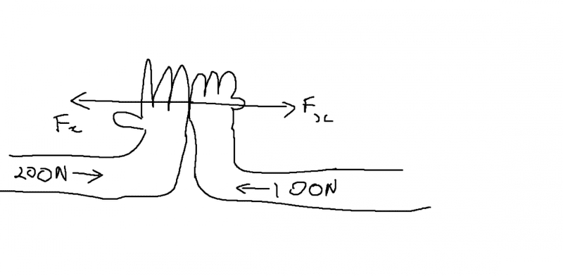

Is this correct? Even though the force applied by the muscles is different, Fx is the same(action-reaction). In this case what would be the magnitude of Fx?

The drawing is not clear enough to allow details to be extracted. One possibility is that the force by the left arm on the left hand is 200 N and the force by the right arm on the right hand is 100 N. In that case, the hands will jointly accelerate rightward as the left arm wins. The acceleration could be calculated if the mass of the two hands is known.
Edit: Another possibility is that the left arm muscles are tensed so that they would produce a 200 N force if applied to a motionless target and the right arm muscles are tensed so that they would produce a 100 N force if applied to a motionless target. But, In fact, the hands move rightward. The left arm is able to develop less than 200 N of force on the left hand and the right muscle is able to develop more than 100 N of force on the right hand, so the acceleration and movement is lower than a simple calculation would suggest.

Alright. But is it correct that Fx force would act on both at the point of contact?
Thus the acceleration of the right and left hand would be 200-Fx/mass and Fx-100/mass respectively?

Yes. Assuming that "mass" is taken to mean the mass of each hand.
Since the two accelerations are equal and if the masses of the two hands are equal then it is easy to solve for Fx.

Alright that clears things up. Thanks a lot man, I really appreciate your help.
