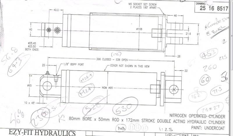

HI,
I understand your concern, this has been manufactured for this purpose with a max 150 bar pressure - it compresses on a ploughing machine if it hits an obstacle. These things work and are built for that exact purpose. My point is that I want to understand the workings, its a self contained unit and can be charged to allow movement between machines. They compress to the full stroke length 172 mm. This won't happen with the speed of a factory type line.
Thanks
Ted

Hi,
Thanks for the drawing and explanation. I do notice that the manufacturers drawing describes this as being a "Nitrogen Operating Cylinder" and I accept that it has been utilized in your application for some time as a compression type unit; but, doing so still results a potential level of safety risk if applied in a new type of design without realizing that its combined N2 charging pressure, load and stroke must be such that the cylinder does not exceed its 250 Bar safe operating pressure at its intended operating full stroke, as you have now identified by your own calculations. For example: My calculations indicate that for your unit with a 150 Bar charge pressure, the maximum stroke without exceeding the 250 Bar cylinder limit is 68 mm with the maximum cylinder stroke of 172 mm (a 31° rotation of the plow tip around the "A" pivot), assuming that there is no retained volume in the cylinder at its maximum 172 mm stroke; .
I am not intending to be critical of what you are doing, I actually applaud your efforts to understand the basics of the mechanics on your unit. I am just trying to assist you by explaining some of the elements you need to consider based upon my over 20 years of equipment design and development for high pressure operating systems.
PS Thank you for taking the time to restate your calculations with the applicable SI units because that allows me to understand what type of unit conversions are being performed. One of the frustrating things for me, being accustomed to US units, is multiple zeros required for some of the basic SI unit conversions.
Thanks for your help,
No problems, once I understand the rudimentary design i.e what's happening , we then moved forward an get it signed off before manufacture.
