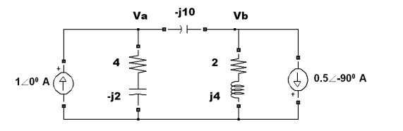

Attempted Solution:
For my two nodal equations, I got:
40j + 20 - 12Va*j + 2Vb *j +4Va - 4Vb = 0
and
2Vb - 2Va - 6Vb*j - 4Va*j-10-20j
Are these right? How do I solve this system of equations?

Regarding your node equations, I don't believe that they are correct; I don't get the same equations, and I can't manipulate mine to match yours.
Can you show some detail regarding how you arrived at your equations?
Use nodal analysis to find Va and Vb
Node at Va:
-1 + (Va/[4-j2]) + (Va-Vb)/(-j10)=0
(-1)(-j10) + [(-j10)(Va)]/(4-j2)] + Va - Vb = 0
j10 + [(-j10)(Va)]/(4-j2)] + Va - Vb = 0
j10(4-j2) + (-j10)(Va) + (4-j2)(Va - Vb) = 0
j40 - 20j^2 - j10Va + 4Va - 4Vb - j2Va + j2Vb = 0
j40 + 20 - j12Va + 4Va - 4Vb + j2Vb = 0
Node at Vb:
(Vb-Va)/(-j10) + Vb/(2+j4) + 0.5<-90°
(Vb-Va)/(-j10) + Vb/(2+j4) + [0 - 0.5j]
(Vb-Va) + [(-j10)Vb]/(2+j4) + (-10j)(-0.5j) = 0
(Vb-Va) + [(-j10)Vb]/(2+j4) + 5j^2 = 0
(Vb-Va) + [(-j10)Vb]/(2+j4) - 5 = 0
(Vb-Va)(2+j4) + (-j10)Vb - 5(2+j4) = 0
2Vb - 2Va - j6Vb - j4Va - 10 - 20j
Interesting. Your reduction method differs from what I'm used to but it is correct as far as it goes. So my apologies for doubting you! I think though that your method leaves the expressions more complicated than they need to be.
What I did was normalize the individual terms first using the complex conjugates:
Node a:
##-1 + \frac{Va}{4 - j2} + \frac{Va - Vb}{-j10} = 0##
##-1 + \frac{Va(4 + j2)}{20} + \frac{(Va - Vb)(j)}{10} = 0~~~~~~## Clearing the complex denominators
##-20 + Va(4 + j2) + (Va - Vb)2j = 0~~~~~~~~## Multiply through by 20 and lose the denominator
##-10 + (2 + j2)Va - jVb = 0~~~~~~~~## Collect terms, divide by 2
Node b:
##\frac{Vb - Va}{-j 10} + \frac{Vb}{2 + j4} - \frac{j}{2} = 0##
##\frac{(Vb - Va)j}{10} + \frac{Vb(2 - j4)}{20} - \frac{j}{2} = 0##
##(Vb - Va)2j + Vb(2 - j4) - j10 = 0~~~~~~~~~## Multiply through by 20 and lose the denominator
##Va + (1 + j)Vb + 5 = 0~~~~~~~~~~~~## Collect terms, multiply through by -j/2
Presumably we should arrive at the same values for Va and Vb when all is said and done.
The equations can be solved by the usual methods (but using complex arithmetic). Substitution looks like a good choice.

I ended up getting:
Va = -1 + 4/j
Vb = -4/j
Are these right?
Unfortunately those aren't the values I obtained.
It looks like you're having trouble with your solution to the equations. If you would post your work, we can give you help; if you don't post anything, we can't help.
I redid it and got:
Vb = 2-4j
Va = 2j - 11
I think your result for Vb is the negative of the correct value.
For Va, do you really mean that -11 for the real part; could you have been hit with key bounce? I get -2j + 1, again you also have a sign error.
Perhaps gneill will verify my result.

This is how I'm doing it:
NodeVB: Va + Vb + jVb + 5 = 0
Solve for Va: Va = -5 - Vb(1+j)
Sub that into equation of Node Va
-10 + 2Va + j2Va - jVb = 0
-10 + [-10 - 2Vb - 2jVb - j10 - j2Vb - j^2*Vb] - jVb
-10 + [-10 -4jVb - j10] -jVb
-20 - j10 = 5jVb
Vb = 2-4j
The problem is just what I thought, an arithmetic error.
You are calculating (-20-j10)/(5j)
I hope you're not changing the sign of 5j when you brought it over to the left side to divide it into -20-j10 are you?
In other words, did you do (-20-j10)/(-5j) ?
Your problem can be broken down into 2 parts: -20/5j = 4j and -j10/5j = -2
Show how you solved for Va.

I mistaked -25j^2 for -25 instead of 25. My new answer for Vb is now 4j-2
-20-5jVb-j10 = 0
-20-j10 = 5jVb
(-20-j10)/(5j) = Vb
Vb = [(-20-j10)/(5j)] * [(-5j)/(-5j)]
Vb = (100j+50j^2)/(-25j^2)
Vb = (100j-50)/(25)
Vb = 4j-2
Correct. Now what is your answer for Va?
I got 1-2j
Correct.
