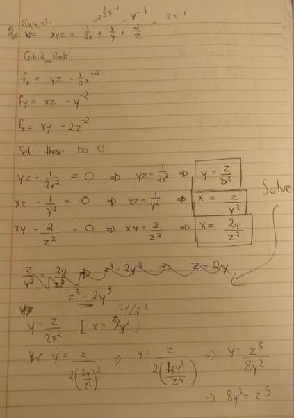

Printed math problem: Find the local maximum and minimum values of the function xyz + 1/(2x) + 1/y + 2/z.
[/B]
Hi,
I seem to have this issue with solving the a system of 3 equations when trying to find the critical points for a 3 variable function.
It always keeps happening. I keep getting stuck when solving these equations. Every single question has its own little trick in it on how to solve these equations
Handwritten derivation finding critical points of f(x,y,z) = xyz + 1/(2x) + 1/y + 2/z: partial derivatives set to zero, then x, y and z solved in terms of one another, ending with 8y^3 = z^5.
Any ideas? I need to do this as the first part in solving my question. I need to find the critical points then use the second derivative test to determine the type of critical points. I keep going around and around with equations, trying to fit them into other ones and it leads me nowhere.
why is it that in your working
yz = 1/(2 x^2) becomes y = z/(2 x^2)
similarly
xz = 1 /(y^2) becomes x=z/(y^2)
and
xy=2/z^2 becomes x = 2y/z^2
it it that i am missing something or is it did you make a mistake?
similarly
and
They are all mistakes.
Oops. seems like i forgot some basic algebra. Give me a second ill fix that up.
